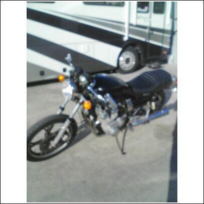

Bars arived today and are on, tires and wheels are on, have a few details to figure out then i can start on the paint. ill take some good pics tomorrow...

just a little update........
got a new throttle cable, choke base, bars are where i want them, built a vacuum guage setup to adjust the carbs, i need to pick up 4 nipples to pull vacuum off each intake runner but will get them tomorrow......
here is a pic of my diy carb sync thing.....
harbor freight vacuum guage, fish tank airline valves (one for each cylinder), done.....open the valve for the carb you're adjusting
and a few pics.........i'm hoping to start bobbing the rear next week and glassing up the seat/rear section new front fender is on the way......still need to figure out what mirrors to use......

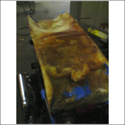

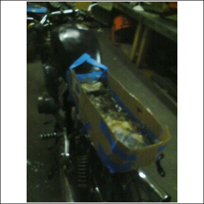

made a little progress......the fiberglass seat panel base is done, next step is to fab up the rear hump and find some taillights, probably going to use dual round led types......
a few camera phone pics....the seat will end up being a couple inches lower than the stock seat.....
the mold, basically i taped the hell out of it and used mold release wax....
the bottom side, notice the hump in the front, that lets it slot into the stock seat bar on the tank to secure the front...
trimmed and ready for stage 2.....

made some progress......
to make the rear hump i waxed a bucket which was close to the dimensions i wanted, then poured in a mix of 75% bondo and 25% fiberglass resin (to eliminate any bubbles and for a smooth finish), when that cured i layed in some fiberglass matting and more resin. finished product is a panel which will require minimal sanding
cut it down and duraglassed it to the seat pan part in the position i wanted.
i'm going to use 2 round taillights which i'll cut into the rear of the panel.....and i'll be molding/shaving all the lower edges as they aren't perfect.
i also need to fill in the rear so it doesn't resemble the bucket or a small keg LOL
a few pics....
