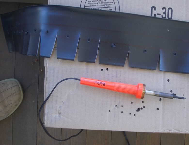

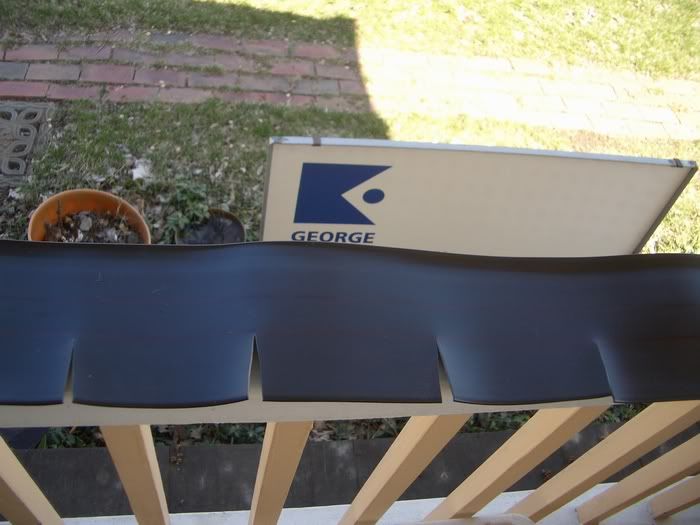

So there I was well on my way to 20 mpg. At half a tank 20 mpg, at 3/4's of a tank still 20 mpg..........then the weekend came and a dozen short trips took me down to 19 mpg in the end. I think it's safe to say the chin spoiler has given me the 1.5 mpg increase I expected and 20 MPG highway. The chin spoiler however does nothing for under 45 mph stop and go city driving.
PHASE II:
I have a roll of black 4 inch vinyl cove base material which I may attach to the bottom of the chin spolier. I would install this parallel to the road surface, and zip tied perpendicular to the chin spolier. My intention would be to redirect any air tumbling downward, off to the sides. I've been looking at a lot of chin spoliers lately and think this could be good for another 1/2 MPG without lowering my obstacle clearance.

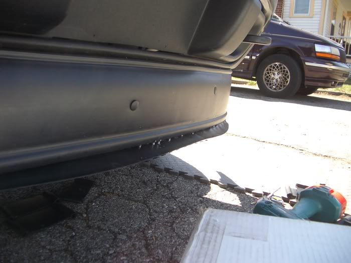

PHASE II
This did not come off as easy or clean looking as PHASE-1, but it works for me.
Some of the securing screws could be seen and there was some uneveness, so covered it up with black silicone. I hated doing that, and the final look is not great, but it's not the end of the world either.
I was able to test it alone and determined it yields an extra 1/2 mpg, now at 20.6 mpg (was 17.6 at one time before any mods).
Material: Vinyl base with cove, it really needs a pressure bar of some sort and not the point to point system of self tapping stainless steel screws. However, this would take away from it's flexibility and impact survivability.
Photo Gallery
http://s184.photobucket.com/albums/x295/kach22i/S10%204x4%20Pick%20Up/?start=20
The cuts and holes did not help much, some ideas are not as well thought out as others. It's an experiment and a learning process.

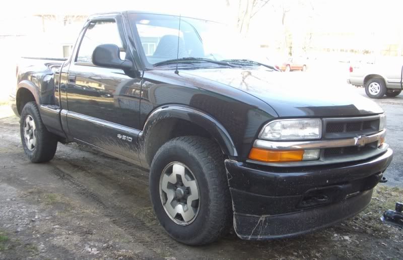

It's been on 3-1/2 years and I really should have replaced the chin spoiler in the fall because the plastic was cracking at the top and bottom seems. It's not from me hitting anything, it's from the plastic aging, plus cars/trucks backing into it while I'm parked on the street.
I tried "water resistant" Gaffer's tape as a temporary repair, wasted half a large roll only to find it invited more idiots backing into it, and a heavy rain proving that resistant does not equal water proof. I power washed off what was left after only a few days.
I went to Lowe's and found some 3M waterproof gutter tape for about $9.00 a roll, I used two rolls on a warm January day and spent another hour on installation.
I used left over lawn edge material and black silicone to block off some opening in the lower front valance.
I still need to test drive this new treatment, I back sealed a lot of joints which should work to my advantage..
I need to put air in my tires too, now that I look at the photos.
I hope this spoiler patch gets me to spring time. Then I'll try some heavy duty conveyor belt material from Tractor Supply. I will not be able to attach that material to the light weight plastic factory valance, and I think it would look ugly to do all the way up to the underside of the metal bumper.

UPDATE 12/09/2013
I got the truck ready for winter by repairing the front chin spoiler.
I actually kept the old one in place, reusing the tube like top structure of the lawn edging as the screw in point for attaching the 7" conveyor belt material.
It was a very simple installation, except for the costs for upgrading materials, $80 at Tractor supply for 7" x 15-feet of conveyor belt, lots of extra left over , which I'm sure I will use in a project one day.
S10 4x4 Pick Up Photos by kach22i | Photobucket
I silicone sealed up some joints, not sure if the stuff is ever going to dry, may have frozen while in storage in my basement. I'll just power wash it off if it does not cure.
I did a 80 mph test, the front spoiler concaved on me at the middle, needed additional support.
I attached aluminum channels to the ABS rock guard, and notched the channels with a grinder, and then bent into an arch and attached with bailing wire a steel wall standard (shelving type) to form the bow reinforcement.
Ready for winter.......................
Rock steady at 70 mph, it feels more like 55 mph. And 80 mph feels like 65 mph going by seat of the pants resistance feeling.
Peaked for a moment at 90 mph while passing a semi, felt like it was meant to cruise at that speed all day long. No more chin spoiler deflection at highway speeds, a beautiful thing.
