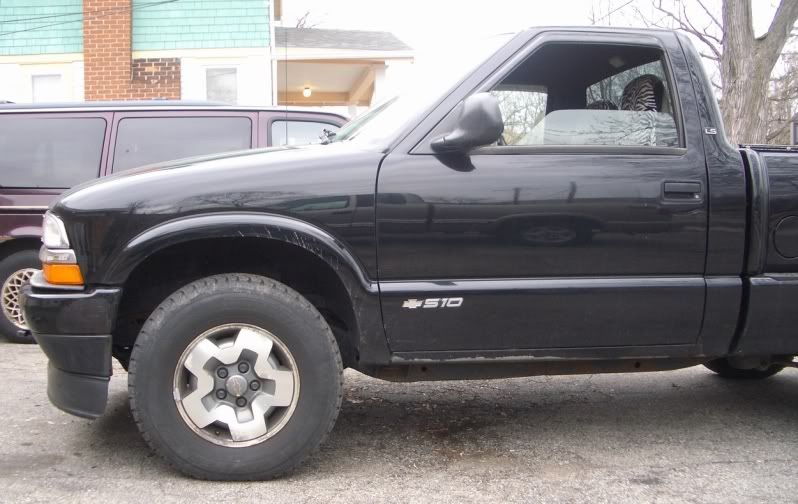

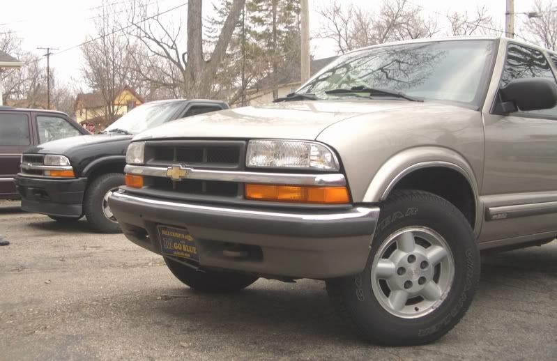

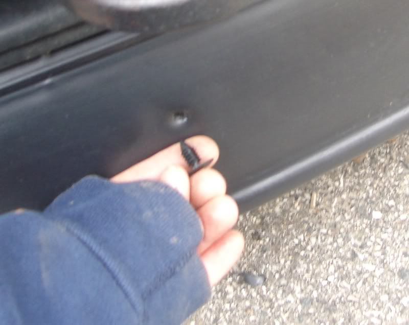

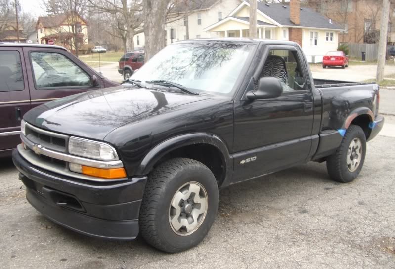

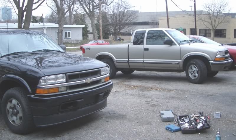

Extra deep garden edging 6" deep x 20 foot long coil purchased at ACE Hardware for approx. $12.00. Secured straight up though the lip with a dozen Stainless Steel #8 Phillips screws 32 tread count, 1 inch long, lock nuts (nylon insert type) 9mm. I'll post the fuel savings later in the week. For the first 50 miles driven today I've gone though less than 1/8 of a tank, normal is a hair over 1/8 tank. At 70 mph the engine is turning at 2,050 rpm, I think that is about 200 rpm less than before. So it's like I'm driving 5 mph slower than actual speed on the highway, and that is bound to add up. Only a couple of hours to install. Photo Gallery http://s184.photobucket.com/albums/x295/kach22i/S10%204x4%20Pick%20Up/ ![]() I have enough material left over for two more trucks. ![]() Automotive plus fill the binding holes, first securing point is centered. ![]() ![]() Curb clearance is reduced from about 13 inches down to 7 or 8 inches, still double of my old Porsche 911 which has more of an overhang. I'm used to not pulling all the way up to a curb, don't do this modification if you are a curb knocker, or at least use a standard 4 inch PVC lawn edging in lieu of the deeper 6 inch one shown. ![]() ![]() Some air gets in through the tow hooks, I'm not going to block these off until I can test engine temp's in summer while towing. ![]() ![]() ![]() Compare it to my neighbor's stock S-10 4x4, from mid bumper down all that air gets compressed then sucked up under the vehicle by the vacuum/neg air pressure under the floor and tumbles around in drag causing vortexes.

Yep, 7-1/2 inches of ground clearance is about double of most cars even ones which go though a Michigan winter. It's designed for some snow and those ruts which form in the snow from tires. The plastic lip of the original valance is a weak point, I could used metal straps and go up an extra 6 inches or so to secure to metal. However the new chin spoiler is flexible with a top loop which can compress with vertical loads. If impact loads occur they will be evenly distributed. It's an experiment, time will tell if it works out.

2,050 at 70 mph 2,150 at 75 mph 2,300 at 80 mph Before the front chin spoiler was put in I think rpm's were up another 200, I'm looking to go from 18.5 mpg to 20 mpg. I just noticed the rpm's today because the radio seemed some much clearer and more detailed without the extra engine noise.
