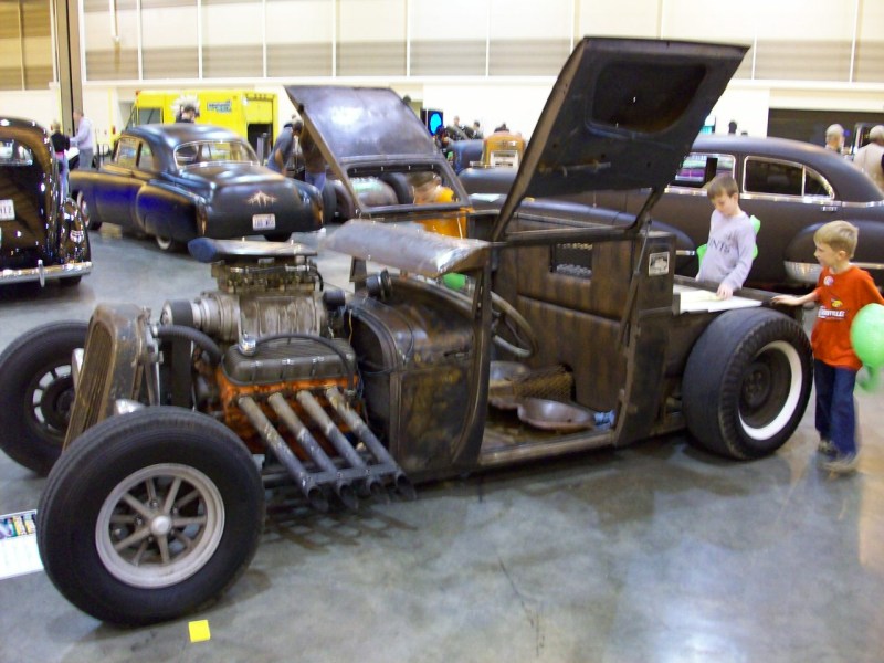

So what is the frame? Front axle? Discs up front? Model A? Home built? Inquiring minds wanna know. And the roof is ingenious! More pics please...and how 'bout some interior shots...

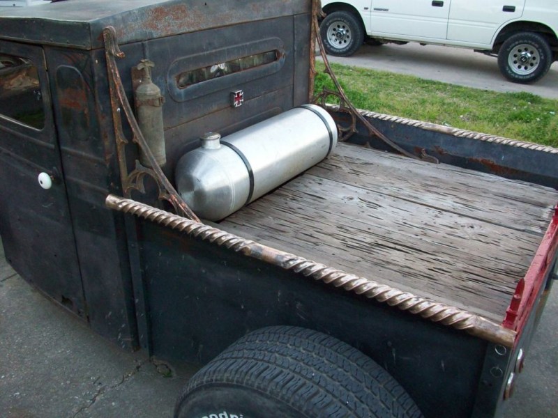

homebuilt box tube frame, suicide front axle, front discs, rear drum, 305 sb/auto. just recovered bench seat with vynyl which now has burn holes from mig welding brackets on inside roof for lexan tinted windows when not in use. and added some antique wrought iron trim and brass bedrails made from keel coolers that's been under an offshore boat for 30yr.

John, that is one cool rat rod. But what are "keel coolers?"

it's a type of external radiators run under the boat for the main engines. the old types like the ones I used were brass tubes about 6ft long run in series. other types are channel iron or 1/2 pipes welded along the hull under the water line. my friend that runs a fleet of boats gave me a bunch of old brass tubes he had replaced

Door handles are cool...what is the coiled copper line and bottle up near the radiator?

door handles are antique porcelian house door knobs. I have a clear glass door knob for shifter knob and also air vent pull. the coiled copper tube and whiskey bottle are the overflow bottle for the radiator.
