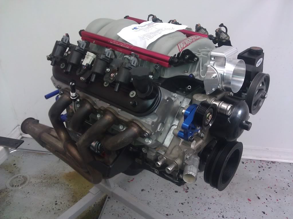

angela
That's actually a ported FAST 92mm intake. They're NLA and sell used at a premium. Reason is, they're easier tune on a 5.7 liter engine than the 102's that FAST currently sells. The FAST systems aren't much different that the stock intake except that they are larger and breath better. With the cam and heads I'm using, it's a must have.

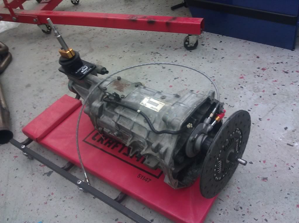

GG Allin 08-04-2012 08:48 AM
Suffered a major set back, back in June. Going out to the garage, I had two choices, start swapping doors on my 98. Newly acquired rust free units:
http://i909.photobucket.com/albums/a...610_001155.jpg
Or mate up my motor and trans then get them ready to install. I should have ****ed with the doors.
I ran it to some trouble trying to get the trans flush with the engine. Something was binding up. Still don't know what it was. So I decided to remove the bell housing. The bell housing then went on the motor no problem. Next I got the trans in position and now with a little better view was able to get the splines the clutch disc and the input shaft to line up. The trans just did not want to easily mate up to the bell housing though. With only about a 1/4 of an inch to go I just decided to draw the trans in with the bolts. Big ****ing mistake.
Here's my block.
http://i909.photobucket.com/albums/a...609_221929.jpg
http://i909.photobucket.com/albums/a...609_235311.jpg
Yes, I screwed up in a big way. But the only way to look is forward.

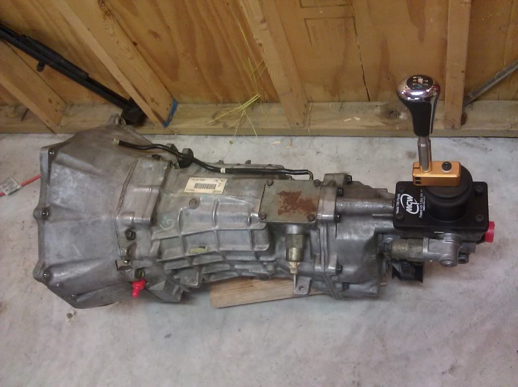

Fast forward to more recent times. I have a newly built LS2 short block to pair up with all my other parts. Got the engine back together. Got the trans and motor together. Didn't crack any blocks this time. And have gotten to the point where the engine is in the car. There are a few fitment issues, but they're minor and should be worked out this weekend. Next up will be wiring and getting everything else connected. Hopefully the extra .3 liters are good for something.

turbo6bar 08-04-2012 09:35 AM
what transmission is that?
