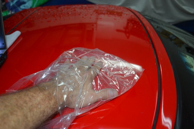

We are often facing the question of what is the best way to achieve maximum results using our product line. So I have decided to do a small write up of how “WE” do our detail jobs, I say “We” because there’s many ways to do a detail job, this is what works for us and doesn’t represent the only way to go about it. This is a system that we've used.
Step 1: Vehicle Placement -
To start your detail job, you want to make sure your car is not in direct sunlight and that the surfaces on the outside aren’t hot. If shade cannot be found, you can wait until late evening so the sun isn’t at its full intensity.
Step 2: Vehicle Surface Evaluation -
Vehicle surface evaluation, one of the most important aspects of a successful
detail job, is the evaluation of the vehicle surface. This evaluation will allow us to prepare ourselves with the correct products and steps, things like light scratches, swirl marks and other paint imperfections can be evaluated at this time. From there we will have a plan of what products are needed and in what order.
You want to prep your washing materials first so you won't be running back to get items from storage while water is on the paint or wheels. You can use a pressure washer usually with no problems, just use caution when doing so. You don’t want to get too close to any surface of the car with high pressure water, especially to pin stripes or emblems. Failure to do so can result in inevitable damage
Step 3: Rinsing Vehicle / Pre-Wash -
I start off by rinsing all the loose debris from the top of the car working downwards. You want to make sure to get all of the loose grime off of the surface so you don’t have to use your wash mitt. What I like to do at this point is just hit all the surfaces including, wheels and tires.
I found out with this process we could avoid causing swirl marks, at least to a certain degree. Very often as you wash you may be dragging loose grime which will scratch the vehicle's surface. These steps are by no means a solution, but
rather a preventative action.
Step 4: Tires and Wheels Washing -
Washing the tires and wheels removes all loose contaminates from the exterior
surfaces of the car and leaves a clean and prepped surface ready for other steps in the detail. You will always want to wash the tires and wheels first, so water doesn’t sit on your clean paint and get baked in by the sun. For the tires, wheels and wheel wells you will only need a few things. You will need a separate set of
wash materials so your paint does not get contaminated by the metal particles and dirt on your tires and wheels. Do not use the same wash water or tools on the paint as you did your wheels. I like to have just a simple soft bristled brush.
There’s a big misconception that all wheel cleaners will stain you wheels. All do in part, this is true. The majority of wheel cleaners will indeed stain and damage your
wheels. The formula must work well on plastic wheel coverings as well. The product must be pH balanced and such as will not stain clear coats! Start with your tires and wheels first. Don’t wet the paint. Prepare your wash materials and get started doing the wheels, tires and wheel wells, one-by-one. Don’t do all of them at once; you don’t want any of these cleaners to dry. I like to start out by rinsing the heavy debris from the tire and wheel well area. Most of the time mud and loose dirt accumulate in these areas, and you don’t want to be scrubbing that dirt all over your wheels.
I start out by spraying down all areas. By the time I’ve sprayed everything, it’s had enough time for me to sit and start working. I use the detail brush first to get to the backside of my wheels and get all that brake dust out of there. Nothing looks worse than a clean wheel where you can see a dirty backside. After that step is done, I take my soft bristled brush and work on the face of the wheel. Light agitation is all that is needed. Last I work on the wheel wells with my long handled brush making sure to hit every part in the wheel
well.
Wheel wells are a really important step to a complete detail, and you have to make sure they are spotless. While you are washing, make sure when you dip your wash tools in the bucket to dip them in the rinse bucket first to remove all the dirt and then dip them in the soap bucket so you are getting clean soap. When you are done with each wheel, rinse the wheel and make sure the entire cleaner is off the wheel. Repeat for the other wheels. Make sure to rinse any undercarriage areas that are visible.
Step 5: Preparing to Wash the Vehicle -
Before wetting the paint you will want to prepare your wash bucket and tools for the paint. In this step you will use a car shampoo that is highly lubricated formula with unique foaming quality and quick rinse characteristics
Your goal is to SAFELY lift dirt and grime while helping to prevent swirls resulting from washing. The car shampoo safely removes dirt and grime without removing waxes or sealants. The shampoo is specially formulated to be absolutely harmless and safe for your car surface. The use of the wrong shampoo that doesn't remove the grime and dirt combined with a low quality sponge/applicator will eventually leave Swirl Marks in your paint surface, something that all of us try to avoid.
The car shampoo must be pH 7 balanced, something that you don’t find on those purple gallon jugs at your local store for $2.99.
One of the most common mistakes that customers make is to invest in a good quality wax only to use an inexpensive /low quality car shampoo. Using the wrong type of car shampoo will remove the wax that you had previously applied to protect your investment. Good car shampoos will remove dirt and grime without scratching and will NOT strip the wax. We used a 5 gallon clean bucket of water mixed with a ½ of a lid of car shampoo.(depending on the product is the mix) During the washing process we incorporated one of the most revolutionary products in the market today, the Oxidation block.
Step 5a: Oxidation and Bug Removal -
Oxidation and Bug remover can be used to quickly and safely remove bonded contaminants, droppings and insect grime from automotive finishes.
This product has the same function and is as environmentally safety as clay-based stain removers.
The value and benefits:
1) Just use with water, no need to buy other tools or special detergents for rigid stains.
2) Reduce over half the time of removing contaminants: User friendly and very easy to remove droppings, insect grime and contaminants which have bonded on paint finish.
3) This product also has the same function of clay-based bars. When use properly, this product will work better than any clay bar.
4) Lifespan of product is 20 to 25 uses if properly used and stored.
5) If block is dropped on the floor, simply rinse it down.

Step 5b: Washing the Vehicle -
With a new, high quality washing mitt and the bucket with the car shampoo we will work on sections. We wash the surface and immediately rinse. We then dip the oxidation block in the bucket which has the soapy solution. After that we proceed to pass the block with a horizontal motion to all the painted surfaces, one section at the time.
Do it section-by-section so the soap doesn’t dry. If it does dry, just re-soap the area and rinse again. I do the rear of the car and the front bumpers last, as these have the most grime. You want to wash in long sweeping strokes, don’t wash in circles.
Step 6: Drying Vehicle Surface
When you are done rinsing the car of all the soap, you want to remove the nozzle from the hose and do what’s called the “flooding” method. Flood the surface of the car from top to bottom with the hose. This turns those thousands of little beads of water into one big sheet, and it helps dry the car faster. After that is done, use a waffle weave drying towel from the top down to dry the rest of the car. There should be very little water left on the surface of the car at this point. Make sure if you see a spot of dirt you missed, or loose debris on the car, that you don’t touch it with your drying towel. Re-wash the area and then dry. I usually use a couple of inexpensive micro fibers to dry the wheels and tires. Wheels can get water spots as well, so you want to make sure you dry those along with the paint. Using the proper drying tools is important.
I like to use something called a “waffle weave” towel for drying which is one of the safest ways to dry your car. Another common tool is the chamois and we can go as far as using leaf blowers to completely remove all the water from all the tight spaces and trim. Other options as blowers or air dryers will work.
Step 7: Taping the Vehicle -
Since we are going to do a full detail job the use of power tools will be
needed. As safety measure we tape all the trim areas and delicate areas. The main purpose of this step is “in case” we make contact by the power tool we will not damage the trim area. Not taking this important step while using a power tool could result in leaving “scuffing marks” on the unprotected surfaces. We like to use 2’ masking tape and at times we choose bright colors so they stand out.
Step 8A Pre Wax - ( If no paint correction is needed)
Pre-wax is just as the name implies, to get the surface ready for wax to be applied. Tar spots, tree saps and various other surface contaminates are usually not taken off by a product that is termed wax only. Your better pre-cleaners have a small amount of abrasive in them, and a lot of the wax/cleaners on the market have a very high content of solvents in them. The wax/cleaners with high solvent content in them need to be avoided, as they will eventually deteriorate the surface to which they are applied. Pre Wax Cleanser is especially formulated to be used prior to applying a Wax.
If you're trying to get a really incredible, deep, vibrant shine from your wax, you need to use a pre wax cleanser to properly prepare the surface prior to use of car wax. The benefit of Pre Wax Cleanser is that it prepares the surface after you wash it so that the paint surface doesn’t get contaminated by dirt or anything else
that may keep you from getting the ultimate protection. The process is very close to the one done with the swirl remover. On this step we like to apply the Pre Wax by hand but will remove it via Porter Cable with a white pad and touch it up with a high quality super soft Micro fiber towel. Again, extreme care must be taken with trim and delicate areas. Apply by hand.
Step 10: Car Wax -
We now move to the final step, the application of the car wax. Again we like
to apply the wax by hand and remove via Porter Cable using a white foam pad and finished with a super flush Micro fiber towel. With our car wax you don’t need
Step 8B: Swirl Removal/ Light Scratch and Paint Correction -
In this step you should tackle all of the
above problems. This could be a very involved process that can be addressed with many different tools, so we will concentrate in the Swirl Remover and the Porter Cable 7424XP ( Yes there's other tools out there for the fan of them)
The Porter Cable 7424 or (7424 XP newest version) dual action car polisher started the pro-consumer car polisher market life more than a decade ago. The Porter Cable 7424 is the industry standard dual-action car polisher. A machine that operates by orbiting the polishing pad around a center spindle while the pad freely spins on its own axis. A counterweight on the opposite side of the center spindle dampens vibration for smooth operation. The tool head action, often called orbital, prevents the creation of holograms (symmetrical buffing marks), paint
burns and other forms of paint damage often associated with high-speed buffing machines.
The polishing action of a dual-action polisher closely mimics that of circular hand polishing. With this tool(s) many different foam pads can be used. They come in
many sizes, designs and colors. The color is the industry standard rule of thumb for a certain job and more colors are appearing in the market.
- Yellow Foam Pad- Use for Heavy duty Compound
- Orange Foam Pad- Use for Light duty Compound
- Green Foam Pad- Use for Compound/Polish
- White Foam Pad- Use for Polish
- Black Foam Pad- Use for Machine Glaze
- Blue Foam Pad- Use for Polish/Sealant
Some of us utilize much more advance pads such as microfiber pads and real sheep wool pads.
With brand new foam pads we like to spray a very light mist of water or detailer. Extreme care must be taken when working near the taped areas. I
personally like to start with a speed of 4 and from there work up to the speed 6, but I do most of the work at 4. I also recommend to run the Porter Cable power core thru the shoulder to avoid any contact with the work area and surface area.
To accomplish this task we have found out that the systems that works for us are as follows: Use with
an air or electric Random Orbital Buffer, preferably with a 3/8 stroke. With electric use a medium to
high setting. With air, make sure 90 psi is maintained at the tool when in use.
Step 9: Tire Dressing -
I like to apply a tire gel using an applicator with a very thin layer of gel to the
sidewall. If more shine is desired a second coat can be applied. Most of the time one coat is enough. The tire gel also prevents premature sidewall dry rot and cracking. One of the biggest complaints of today’s car enthusiast is the “sling” created by many of today’s inferior products used to dress your car tires. ( There's actually products out there that wont sling!)
Step 10: Windows
I like to do the windows last using a product for windows ammonia free and a microfiber window towel.
Step 11: Spray Wax/ Detailer
I like to apply one coat of spray wax for the wow factor.
