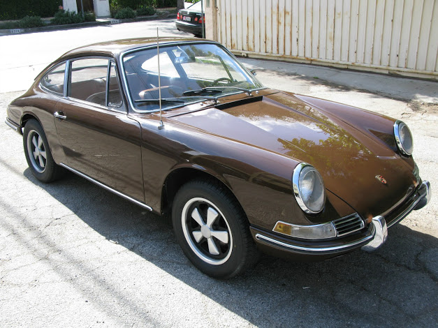

I remember going to a party with my ex girlfriend, and seeing this car in the guys driveway. This was back probably 22-23 years ago, before I even owned a p car. 1976 912 e.
I took my 930 to my nieces b day party last weekend, and this guy was checking it out. After speaking for a few minutes, we realized that we knew each other from the past. 3 days later, he drags it from his shed, and it is in my parking lot. He wants to make it run and drive again. It has not been started for 16 years now. I can only imagine what that gas is going to smell like. Looks like a torsion bar broke while it was stored. It is a little rough.

I guess the plan is to first , get it up on the lift, to evaluate the rust situation. I can see the tell tale signs of a rust bucket. It has been sitting in a shed in Pa, for 16 years so it may be a goner. If it is not too bad, drain the gas, and oil, turn the motor by hand. Make sure the fuel pump runs, 5 gallons of fresh fuel, new oil, and turn the key, and see what happens. Mice have also made a home in it, so who knows what we will find.
Pull the gas tank. Have it cleaned and relined or it could be spitting rust into that new gas. My 911 was a shed find too. It sat for 16 years also. The gas was rank.
