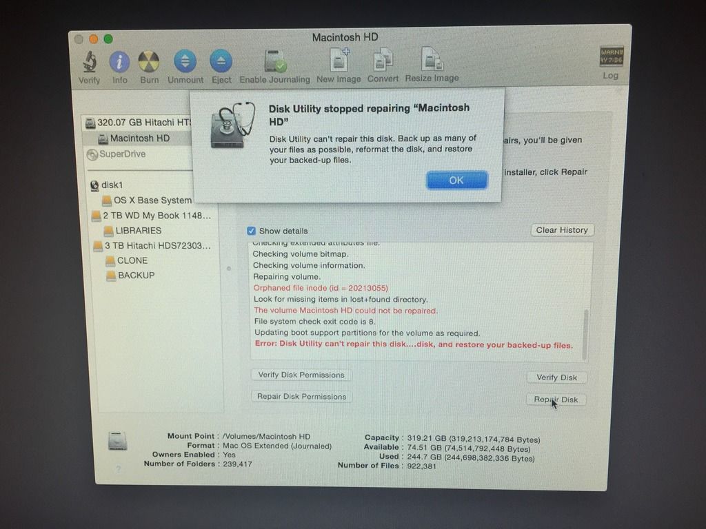

Mid 2010 Mac mini with original 320 GB internal HD, 16 GB RAM, OS X Yosemite. The internal HD is the boot disk, the OS and all apps as well as documents live on that HD. I keep my libraries (photo, music) on external HD #1, a Time Capsule backup on one partition of external HD #2, and use Carbon Copy Cloner to make a weekly copy of the internal HD and the libraries on another partition of external HD #2.
I ran Disk Utility / Verify on the internal HD, and it said the disk needed to be repaired from the Recovery HD. I booted with the Option key to the Recovery HD and ran Disk Utility / Repair on the internal HD, but it said the disk could not be repaired. Here is the screenshot.
What would you do?. I'm thinking I should make a bootable thumbdrive with OS X Yosemite, install a new internal HD, do a clean install of OS X Yosemite on the new internal HD. Then would you #1 restore from backup, or would that simply duplicate all the errors in the current internal HD?. Or would you #2 manually download and reinstall all apps and copy back all data, which will be time consuming. Or is there a better option?

You're on the right track. Back up apps and docs from the current HD. 99% chance the issue is a HD mapping problem. HDs detect bad sectors and remap automatically. But a sector failure in the wrong spot can scramble a directory, which sounds like what happened to you.

I believe #1 will do it. If you have a corrupted directory, the affected docs and apps simply won't work. And you can then replace them as they are identified.

Option 1 will work if you are restoring from a full or incremental back up.
If you have cloned or done byte for byte backups you'll just end up restoring the problem.
FWIW, I ran one of my main boxes for a couple of years with that error. I really did not feel like going through the trouble of fixing it.
Unless it's a critical system or app resource that's lost its almost a "cosmetic" issue.
