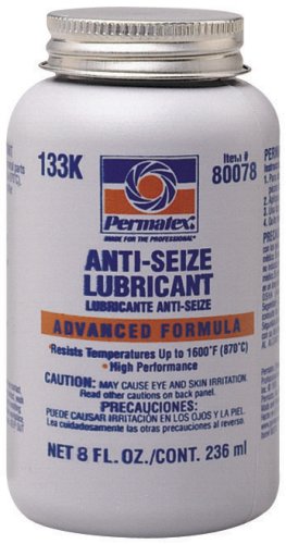

This is what I have been using for years. Amazon sells it. It is blend of aluminum, copper and graphite lubricants The nickel base anti seize is for stainless steel although I haven't had any problems with the copper base anti seize.

That looks like the batch I have only mine is old enough to not have a bar code on it.

That permatex bottle shown above is pretty good at most.
I wouldn't use it on a gas expander, but for most home and automotive uses it's OK.
