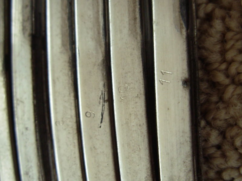

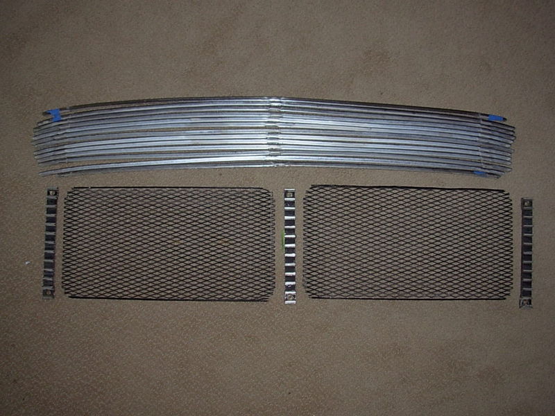

Here's what you can do with the '68 grill. These are photos of mine before, during and after.
Grill before.
Grill removed and taken apart. You can see a bit of the waviness of the bars.
Each bar is numbered.
Bars realigned during a couple hours of watching TV. The remaining parts were cleaned and painted.
Back together again.

5. do those numbers on the grill bars start at the top or bottom. just trying to figure which number I am missing. I am missing the next to last on the bottom.

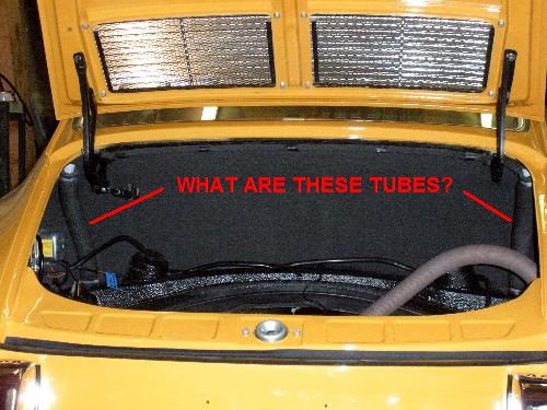

Next question. This engine is complements of DarrylD. Beautiful of course. Question is, what are these tubes? On my car, someone had used pipe insulation wrapped in electrical tape which was totally dry rotted.

Rear defroster.

Oh, now that you mention it, I did notice the vents peeking out in the corners. So what is the proper, factory tubing/ hose to use? Where does the air come from? What prevents the car from filling with fumes etc?

Air comes off the heat exchangers, which if they don't have any holes in them won't allow any exhaust into the heating system. The tubes were originally soft foam with zip ties holding them at each end.

So what is the recommended hose to use? I did not know they had zip ties in 68? I think that is what was on mine, but it looked so hokey I thought a PO had done it.

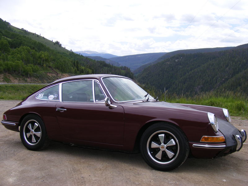

Here is a picture of the grill and another from the 2009 Porsche Parade.

Randal, looks like our cars are sisters. Your car looks like it is in beautiful condition. You have had her a long time. The guy I got mine from had if since 1977, 33 years. My window sticker is from the local dealer, not the factory. I have it scanned at the office. Did you add the Fuchs wheels? Are they 15x6? What size tires are you running?
