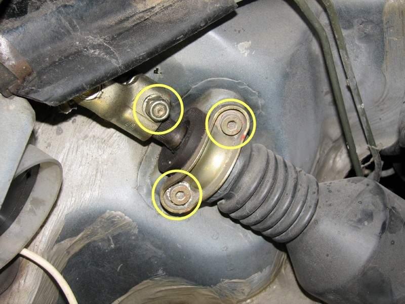

Hi All,
I was cruising on the highway at 65 today, when I felt the steering wheel bind up a bit on the right side. I have never experienced this before and thought it might just be the road. I kept driving while checking the wheel. Soon enough I realized that the wheel had bound in either direction except maybe +/- 5 degrees. I turned on my hazards and was able to navigate off the highway onto a side road.
I pulled the car over and shut down. With some force I was able to turn the wheel. I limped into a gas station and the wheel seemed to free up. However, when I was testing it, it kept binding randomly. It didn't feel safe to continue so I towed 50 miles home.
Any clue what this might be? There is no play in the steering wheel so I think the upper steering shaft bearing is ok. The U joints looked ok and greased. Maybe it's the lower shaft bearing?
I'm going to diagnose tomorrow, but I'm not sure what to look for. Any help is appreciated.

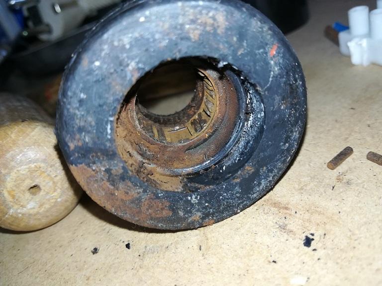

i am just now doing a job on one 911 with the same problem .It most likely your steering shaft bearing.Inside the rubber is needle bearing if it is old the little pieces will fell out creating the problem...one more thing..to investigate you have to remove the allen head bolts,but be careful they will strip easily..so hit it with a hammer before trying to loosen it...with the allen socket on the bolt...
Ivan
Old 06-30-2019, 09:41 AM
proporsche's Avatar
Join Date: Sep 2011
Location: Bohemia
Posts: 7,484
here is how it looks when it is kaput....

I took everything apart yesterday. If you want more detail, check out my Instagram account (@valveandpiston) where I documented the process.
It looks like the culprit was the lower shaft bearing. When I took the bushing/bearing off, it felt like clay was lodged in the needle bearings - very gunked up. After cleaning the bearing with brake parts cleaner and applying some silicone lubricant, I felt that it could be salvaged. I also cleaned the U-joint, but did not apply any lubricant. The U-joint was very tight. I took it for a test drive and didn't feel any symptoms. See below for before/after:
Before
After
And a picture of the steering shaft, which I cleaned up as well.
However, I am still a little worried that this was not the entire issue and it could be the steering lock mechanism...
