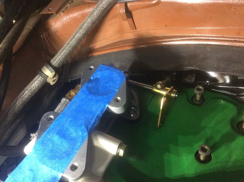

Picture showing the rod with linkage for throttle to attach to.

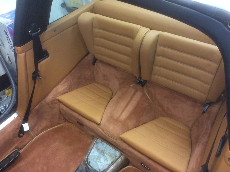

Goals and milestones...
This week, I told myself I need to get the rear interior all installed this weekend. Lots of struggling trying to get new holes in leather to yield the holes beneath- the parcel shelf luggage strap brackets really fought me along with a few other random screws.
Mission accomplished new seat belts and all the rear pieces are now leather; they were all vinyl originally. Not experiencing that new leather smell yet- garage is only 50F, need a bit of heat to help it give off it’s odor.
Rutager West

Fantastic!! Looks awesome - congrats! I have mismatched back seats, but not sure what the next step is before getting some of the ITB work done.
