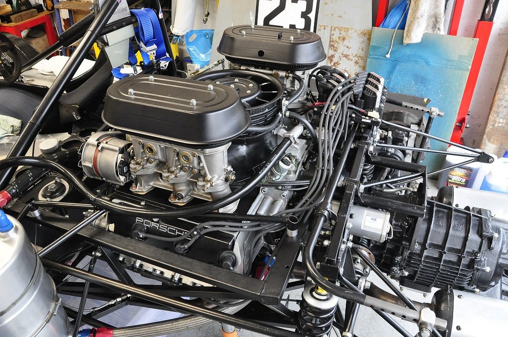

Hello everyone who may read this.
I have bought a Clewett/ electromotive XDi for my competition car fitted with a fresh twin plug 3.2 flat 6.
After 40+ hours it will not produce any spark.
I have had a very long run with both companies and they have just tested the XDi unit with VR sensor, and say it is trouble free.
The XDi light goes to solid Green when switched on, remains so while engine cranking, drops to solid red when you stop.
The manual says the sensor is at fault. The sensor gives 4 volts and 620 ohms and a perfect sinusoidal wave form.
I am at my wits end with both companies and getting nowhere except being asked for more money.
I live in England, makes things far harder.
Can anyone on here shed any light on this please with positive suggestions?

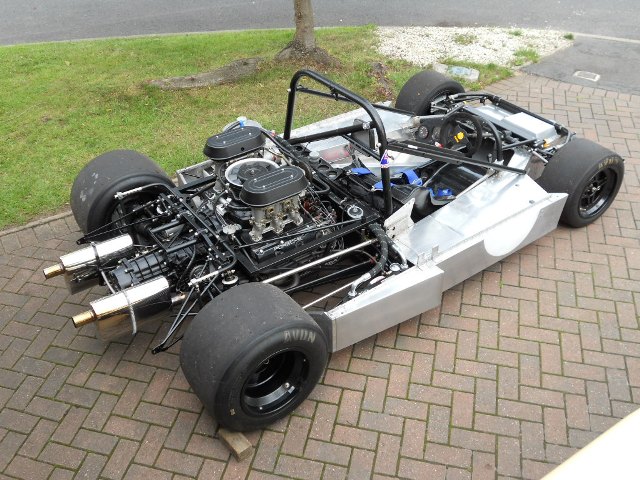

This is the car:

To be clear, the 40+ hours that you reference ... that's a reference to the XDi running previously on your car?
Separately - once you get this issue sorted, more pics and info about the car please!

Old 03-13-2022, 10:43 AM
Join Date: Jul 2015
Posts: 42
Hello everyone, and specially to John!
To give some details:
Bought the XDi new a few months ago for this engine. Came from Clewett, a kit for a twin spark 911, 3.2.
Spent 40 hours installing it in the frame of this car and tried to start the engine. No spark, just a solid Green light on the XDi including when cranking the engine. When I stopped trying to start it, the light goes solid red.
Had many many emails to Clewett who gave a lot of answers and suggestions, None worked.
The conclusion was the XDi had to go to Electromotive at my cost. I am in England.
The unit was tested by Electromotive and stated to be "trouble-free".
It was suggested I buy a Hall crank sensor for $149 plus shipping and customs duty.
I also have to pay to have the XDi returned to me.
This action will cost about $500 on top of the purchase cost of $2000.
Electromotive also wished me to have a nice day.....condescending in my mind.
I have still nothing to start this expensive twin plug head engine. I have started it carefully using a simple distributor and coil and it runs great.
The point of this thread on Pelican is to reach out to anyone with XDi experience who can shed light on this failure to work.

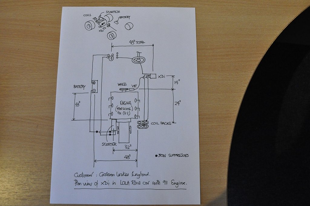

Old 03-16-2022, 02:49 PM
Join Date: Jul 2015
Posts: 42
Indeed they supply the XDi unconfigured, but I have set it (and checked it many times).
I really have gone though the Manual, through all of Clewett's suggestions, Electromotive's too.
I've had 2 people with ignition deign experience visit the car and spend 5 hours going through the basics and experiments.
I have re-configured the whole layout of the system's components, I've examined the sensor's output, the XDi running on an independent 12.7 volt battery.
I sent it to Virginia for testing at Clewett's suggestion, checked out "trouble-free", $100 cost to me.
I have just paid a further $380 for the return of the unit with a new Hall sensor.
I have about $2100 in this and have never seen a spark.
Maybe it will spring into life when i get it back late next week? Not holding my breath....
This is a sketch in plan view of the car and the system layout and proximity to each other.
Old 03-16-2022, 03:37 PM
Join Date: Jun 2015
Location: westerly, RI
Posts: 36
who made your wiring harness? I'm only asking because I got the elective
motive gt200 from clewett who made my harness and had no spark so when I looked at the harness I found the crank sensor plug to be wired wrong. harness side
Old 03-16-2022, 04:12 PM
fred cook's Avatar
Join Date: May 2001
Location: Deep South
Posts: 5,145
A simple test
Once you get the ECU back in the car, try cranking the engine while looking at the tach. It should register 200-300 rpms (assuming an electric tach) while cranking if the crankshaft position sensor is reading correctly. If not, it will not start.... as you have discovered! What gap are you using for the crank sensor? You might need to move it closer to the sensor wheel. I have one of these systems powering my 3.3SS engine in my SC and it works as it should. Also, double check the wiring going to the control box and make sure you have them all connected correctly. Good luck!

Old 03-16-2022, 05:15 PM
Join Date: Jul 2015
Posts: 42
I appreciate all your replies, always helps.
The VR sensor has been set at 48 thou, 35 thou and 10 thou, no difference.
The signal is far sharper and greater amplitude at 10 thou, Clewett said it will not start so close, 40 is the best, so i positioned it there.
No difference.
I removed the plugs to remove the cylinder compression and raise the cranking speed...
No difference.
The looms are all as supplied by Clewett. I have found one crimped pin connection where the wire pulled straight out already.
Any connections i make are crimped and soldered.
While this XDi is on it's way back I'll go though EVERY wire again, security, position erc in prep for the Grand Day when it will simply start.
The Starter, a hot topic.
It is a little known Brize starter, high torque and very compact. All leads have iron clip-on suppressors.
I estimate a cranking speed of nearly 2 revs /second, but have no means to measure it.

Old 03-17-2022, 06:41 AM
3rd_gear_Ted's Avatar
Join Date: Oct 2007
Posts: 5,185
Certain starter motors and certain ECU's don't like each other.
Big ass wire to the ECU source straight from battery.
Grounding of the sensor leads both ends of cable.
