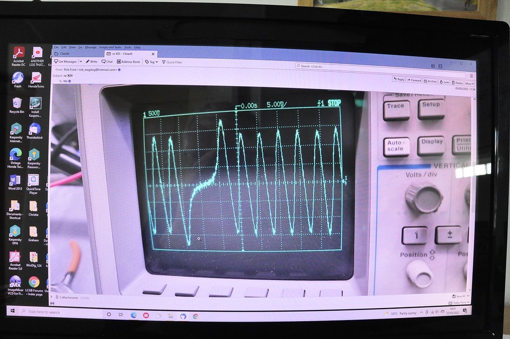

Perfect crank signal (missing tooth TDC) like from a flywheel used on a 964/993, but not a 911 3.2 flywheel which has separate TDC signal.
So where's the scope trace of your cam position sensor signal for your ECU input?

Yep, the XDi box, now tested by Electromotive in Virginia, and deemed trouble-free on testing did not 'see' the VR sensor. Never has in my hands.
You can see the VR sensor output. It looks good to my untrained eyes.
Wires all there and in the right places and connected, tested from the 23 pin plug that would fit to the XDi box through to where the wires go in the system.
What can be wrong?
What can be wrong?
Did you read post #30? Did I describe how the XDI functions? If not, what's your understanding? Did XDI describe how their system functions?
If my functional description in post #30 is correct, the XDI ECU is receiving the TDC signal, but is unable to lock-on to the correct timing.
Most likely it's not detecting a change in engine RPM during the setup time, while the engine is cranking.
The key question is whether you get any spark. If your don't, then the ECU doesn't detect the crank sensor signal. You must have a spark to all cylinders while cranking.

The XDi has a light.
Limited, but it starts on a solid Green on Switch ON. Crank the engine and the solid greed should go Green/red alternating.
On my unit the light stays solid Green until you stop the starter, then the light goes solid Red.
In the diagnostics section of the manual this fault is described.
It concludes this situation means the sensor is faulty and/or the Xdi is not catching the sensor signal.
As you can see, the signal is good the resistance of the sensor should around 620 ohms, mine is 618. Clewett state this is ok.
This light condition/sequence has NEVER changed no matter what I try/have done, yet Electro state it tested 'Trouble-Free'.
There has never been a spark anywhere, anytime.

VR sensor sending out a great signal.
But no spark.
Old 03-18-2022, 11:59 AM

How did you go about testing the existing sensor? Is it possible there is a problem between the plug on the sensor and the plug on the main harness?
My gut says it's a wiring issue.

Sorry, just a thought, but what are you using for the toothed wheel? Did it come from Clewett as well?
When on the oscilloscope, was that the sensor as installed with the engine cranking?
Old 03-18-2022, 01:05 PM
Join Date: Jul 2015
Posts: 42
Yes, that trace was on the engine, 10 thou gap, normal cranking speed.
Scope was on the connector at the end of the sensor lead.
We also tried the same with the polarity reversed, no difference.
The wave form got rougher at 48 thou but generally same shape, less pk to pk volts.
Clewett said engine would not run at 10 thou, 40 is best.
The pulley wheel toothed wheel came from Clewett as part of the kit, 127mm dia., 60-2
I think the XDi is grounded by the large ground wire coming out of the unit, but we did ground the outer heat sinking case to chassis.
Made no difference.

Sounds like you have a good ground so that won't be an issue.
Try doing the same oscilloscope test that you did, but with the sensor harness plugged into the main harness. This would help you eliminate the possibility that there is a fault in the main harness that connects to the XDi box.
Repeating the test that way would tell you if you have a crank signal getting to the connector on the XDi box.
IIRC, the 23pin connector is a snap together design to allow for the addition of an extra coil pack harness. I had to open up my harness when adding the extra coil pack harness when I went from single plug to dual plug.
I really think the problem is in the main harness connecting your known good sensor and the tested Ignition controller.
The XDi is not a very sophisticated piece of electronics and I would have no reason to not believe that it bench tested OK at Electromotive. I wouldn't bother even pugging in the coils at this point, as the issue is 100% the crank signal.
