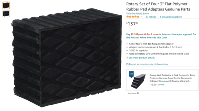

I've used the TW S3 - 10E for a couple years. Did a tansmission on a 997 and a Corvette. Very stable. Would not be afraid to nap under it.
Get this stool!
Prefer the larger rubber blocks here:
