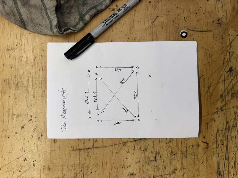

I pulled the measurements from the chassis drawings to more easily calculate the diagonal distances. Here for reference.
The first image show the dimensions from the chassis drawings (hopefully I read everything correctly). The second image show the diagonals. The smaller circles at the top are the front and inner front suspension mounts holes. The outer holes of the front mount are not shown. The larger circles are the 12mm suspension mounts.

I did mine pretty much as shown in the video you linked.
Your dimensions look good. I measured everything as carefully as possible. It came out well.

Interesting that your diagram shows the distance between the front mounts as 653.5 and the diagram I have (below) shows it at 656. At any rate, I don't think this is as critical of a dim bc the suspension does not mount directly to this location. I will use the inner mounting bolts for my main reference points. These are referenced in all drawings.

Took measurements off the car. Some seem a mm or so out of spec but my setup isn’t hyper precise. All are on the short side which leads me to believe it’s how I’m measuring. The diagonals are within a mm of each other which is good to see.
Below is the tram gauge I made for the job using 1/2” square steel tube and some tram points I 3D printed.

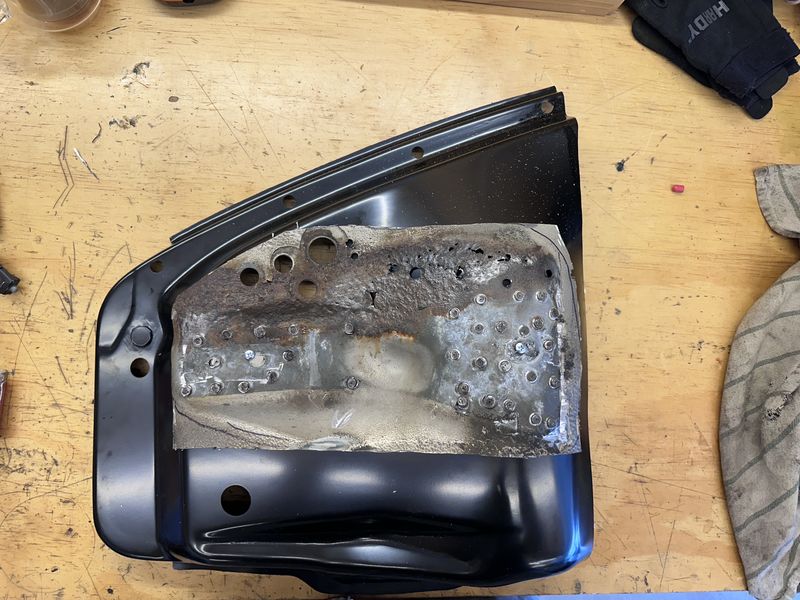

Made progress on the inner fender. I’m waiting on a few parts I had laser cut to make a suspension pan jig so I figured I’d do this first.
I cut out the rusted area as well as the area that the bumper bracket mounted to. Grinding down those spot welds would have been an huge pain, so I just replaced the whole area. I tried to find the best spot for the cut to allow me to access/grind/finish the welded seam. It’s going to be a pain up top but seems like I have enough room. I didn’t remove the fender yet as I want to keep the front end together and rigid until I replace the suspension pan.
Drilling out the spot welds on the inner support was so much easier than the spot welds on the bumper mount. I was happy to see that the plate behind the inner fender looked new. I expect to find more rust as I dig in but not this time!
I lined up the cut piece with the new panel from Restoration Design and fixed it with a couple self tapping screws. I then scribed a line 1.5mm(ish) from the edge and cut. Somehow the panel is perfect top to bottom but too short front to back. The old ‘measure once and cut twice’ trick… It will take a little more work, but will be fine.
Lastly, I painted the hidden surfaces with weld through zinc primer and tacked it in place. Next up will be TIGing it all up, grinding/finishing the welds.

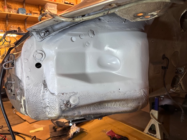

Finished up the welding, ground the welds flat, and put some primer on. Feels good to wrap this panel up! I still need to weld the new bumper bracket on, but I might do that after I tackle the suspension pan.
One thing I’ve realized is that laying down TIG welds when you have perfect access and visibility is like cheating. So much more challenging with your head inside a wheel well. No screw ups but not the prettiest welds. Not important as they were just ground down anyway. The seams visible in the photos are the edges where I removed the underbody coating. The welded seam is not visible.
Grinding took some patience but worked out fine. I also did some work on the inside/frunk to make the weld undetectable. Probably went a little overboard as the underbody coating will cover it all up.
Next up, suspension pan.
