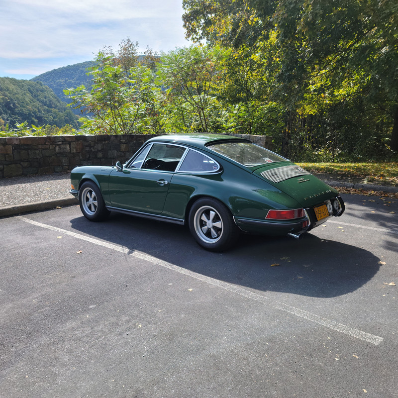

Have you considered Pirelli P6000 in 195/65 on 7s all around? I ran that combo on 15x7 Fuchs all around until very recently.
