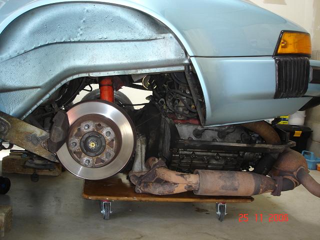

I have a question about Ceramic Coating on the exhaust system. I have recently removed my engine for some minor fix ups (oil leaks and clutch), and want to tidy it up before it goes back in. I have a lot of items earmarked for powder coating, but I recently heard about ceramic coating exhausts as it resists staining from the heat. I have also heard that the ceramic coating retains a lot of heat and I wanted to know if that is true as the air cooled engine works best without heat.
I have removed the heat exchanger tinware, and I feel there are four options to refurb the exhaust:
1. leave them as they are (ugly and rusted looking) - not preferred
2. Paint them with heat proof paint
3. Powder coat them, or
4. Ceramic coat them.
Does anyone have any views on this question?

5. Ditch the crap and get some SSI, or similar.
Either that or nb.1.
I dont think the rest of the alternatives would be worth it.
POR 15 has a heat resistant paint_on_rust paint, could be an option.

Ceramic coating works best for headers, since they are simple pipes without any of the other crap in between like you have. As I understand it, they have to clean the pipes out with media or something before they apply the ceramic coating. I'd try something like media blasting them & apinting with heat resistant paint or the heat resistant POR15.

I'd consider SSI's, but there's still a substantial cost difference compared with the options described so far.
In general, I'd recommend ceramic coating. Exterior surface temperature will be lower thus reducing heat transfer to the engine. I've measured exh. pipe surface temps of 400ºF under the lower valve cover (early 911), and that was only at idle. I'll bet it's higher with a cat. system. Who needs more heat to reject from the cooling system? If pieces are also coated internally, CC will extend the life of the base material, whether it be plain steel or stainless. Prepping the surface is important. Your system must be sand blasted to clean base material. The CC shop should provide this service.

ditto to what Sherwood said - SSIs if you can afford; ceramic coating otherwise (if the cost diff. is big down there)
that assumes you have no emissions regs in Aust. on your SC (it is an SC right?)
- do not expect any magic from a ceramic coating of the headers - much less the mufflers; the real value of ceramics is when they are used as inserts right in the exhaust ports (doesn't the 993 do this?) -- things are already pretty cool by the time the gases reach the headers, relatively speaking

Por 15 makes a header paint. I painted some 914 1.7 headers about 10 years ago. I saw them at a swap meet 2 years ago and I was amazed how well they looked. I painted my premuff (exactly like yours) and it has turned a nice tan color like stainless steel does. Not pitting. The paint is called "factory manifold gray".
Ceramic coating is pretty amazing. On this 914/6 I saw, the owner told me to put my hand near the headers to feel the radiant heat, but to be careful around the muffler because that was not coated. The car had been sitting for 10 minutes after a run. The muffler would have seared flesh on contact. The headers were coated in and out and I could touch them briefly.

I did my HE and muffler in ceramic for about $300, they media blasted them and came out great. They have been very durable and have not chipped or cracked on my 930 which were done about 3 years ago.
Some pics
