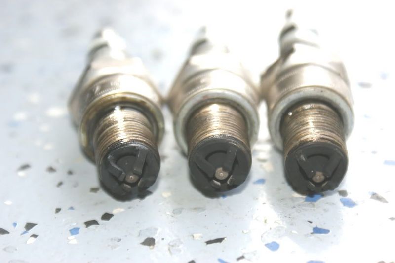

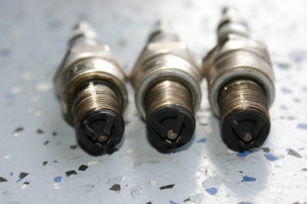

Sparkplug reading (will post pics in a few minutes)
right bank is dry black soot on all 3 plugs indicating a rich mixture. Have a gas smell.
Left bank is clean and wet with gasoline. Almost like they aren't firing. all 3 are the same.
If I unplug a plug wire from the right bank, the engine stumbles.
If I unplug a plug wire from the left bank, no change.
It is a waste spark ignition system (Like TEC, etc.) with 1 coil firing 2 cylinders.

Right Bank:
Left Bank:

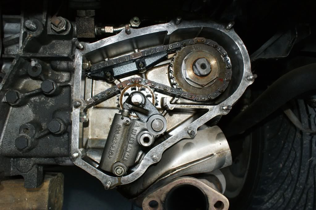

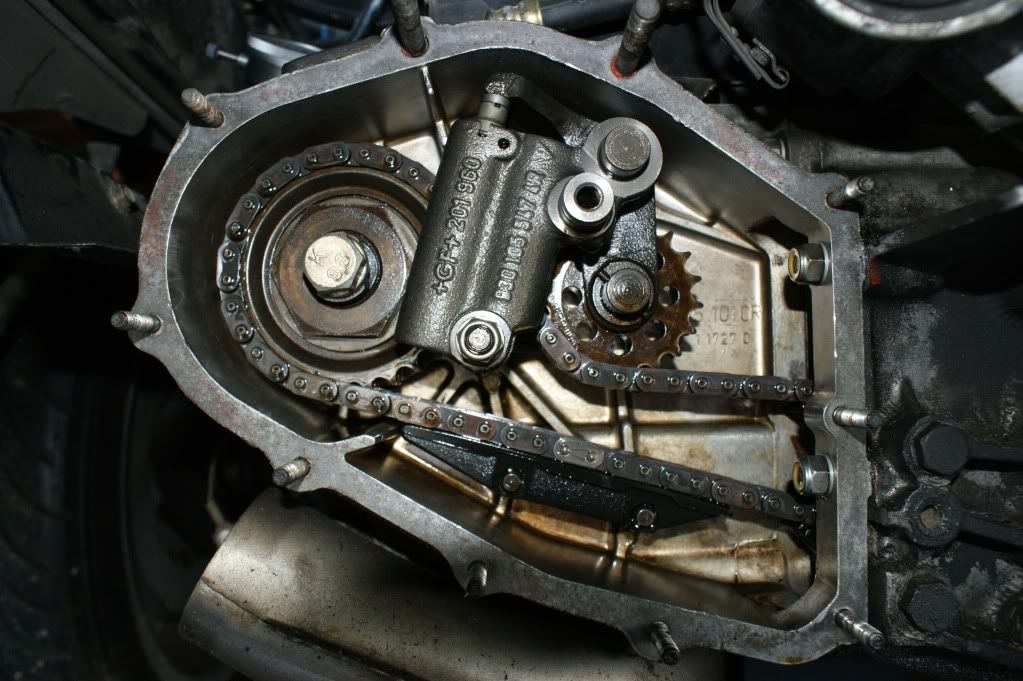

Update:
Well, I got the cam covers off this weekend and here is how the tensioners looked:

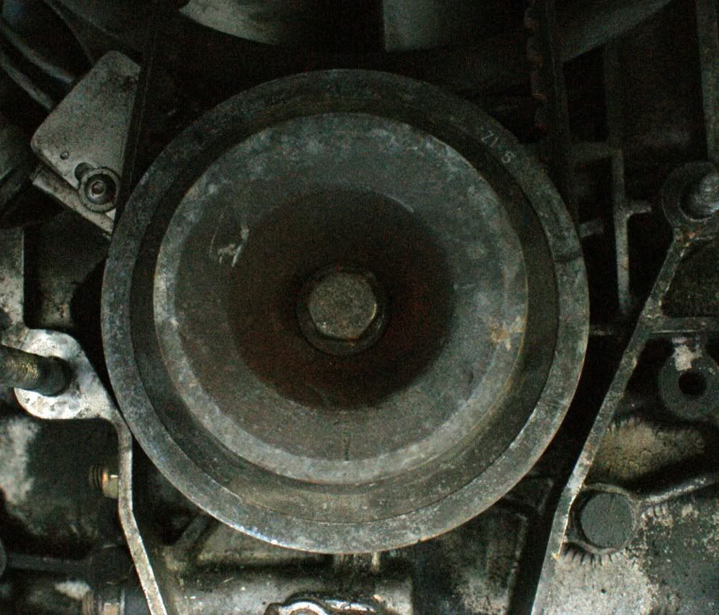

So next I checked the cam timing. Get everything setup on TDC on cylinder #1, rotate 360 degrees, no movment. As I go just past TDC again, valve starts to lower. Cam timing was originally set at 1.0mm(0.040inches). To get the same reading I have to rotate the crank to here:
So left bank timing is off quite a bit, but I don't understand why...
Will check the right bank next.
