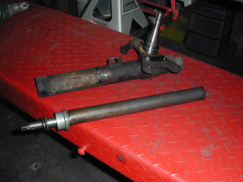

I am in need of new struts, front and back.
I managed to remove the front strut inset s, now the question is what kind of oil do I use to replace the bad smelling oil which was in it and also how much do I put in. The inserts are the one where the Bogi strut it self is the housing and I only replace the inner guts.

just replaced my koni "inards" for koni inserts. What a mess those original parts were in. What you will recieve will be a self contained catridge (strut insert). Remove as much oil for the strut as possible, try to clean out your struts entirely. Replace with the specified amount of antifreeze (that's what my Koni instructions specified).
I've heard that this is to help with heat dissipation, but I suspect it could be to prevent possible freezing & cracking of the compoents as a result of any water being in there; it is a tight fit & any liquid present is helping to form the seal down at the bottom. That's my take on it anway.
if you have Boge oem struts, you will need to specify this to koni in order to get the right part.
it really is all straight forward once you recieve your new parts:

I used the enclosed insert as show in above reply, in my 912 front suspension and I tried the old used 912 insert in my 911 strut and it will not fit.
The part I am thinking is the Part which Pelican offerer's Part # 86-1647. Called Koni insert for Boge strut.
The insert has the check valve on the bottom and the strut housing it self is the reservoir.
By the way, it's a 911T 1972

How could you have any dampening action without any liquid in it. I still say it should be oil. How do you get water into it? you have a seal / O ring below the top nut and the shaft strut shaft moving up and down has a tight seal around.
If you study the open strut you will see a small piston ring on bottom end and a a check valve in the insert housing and a check valve on top of the moving part. The oil it self is the dampening fluid and also is used to transfer the heat to the outside.
Antifreeze has NO lubrication factor and can imagine how much friction there is when that little piston ring goes up and down to dampen your ride. It can't be anything else than oil. even if you should get a drop of water into it, it will not burst the housing or do any damage.
My original question was how much oil and what type. It looks like no body has a real answer.

you are missing a very important detail here. When you order new inserts, you are going to recieve a fully assembled, self-contained unit. SELF CONTAINED. The new insert is the shock itself. The strut (assembly) serves merely as a housing for this new insert. You will toss that mess you pulled out of the strut housing away. No need for it. (wait till your car is back on the road again.)
LOOK AGAIN AT MY PICTURE ABOVE. it's fully self contained. YOU ARE NO LONGER USING THE STRUT ASSEMBLY AS THE OUTER HOUSING FOR THE SHOCK.
This is, off course, if you are infact going to order new, replacement inserts. Now, if you are going to have your old original shock inards rebuilt, that's another story and I really don't have any knowledge on that.
Look at my picture above, again. FULLY SELF CONTAINED. No oil/fluid needed for any damping action.
Hey Fritz, take a look at your picture from above. The upper part is what I call the strut or strut assembly. The lower part is what I'm referring to as the "inards". It looks original. There is relative motion between these two parts, originally. If you order new inserts, there will be no relative motion between your strut assembly, and what you will drop down inside. The new insert will simpley drop in (I actually had to push and use the new top gland nut to fully seat the new insert).
I hope this helps.
~Chris

Yes, I think Fritz is not talking about the same situation w/new self-contained, sealed units.
Chrisf - I guess that's my point (and question too). Why is there a need to fill the void between the new, self-contained, sealed insert and the inside of the strut housing w/antifreeze? It's not really doing anything except taking up space is it?
Tom
