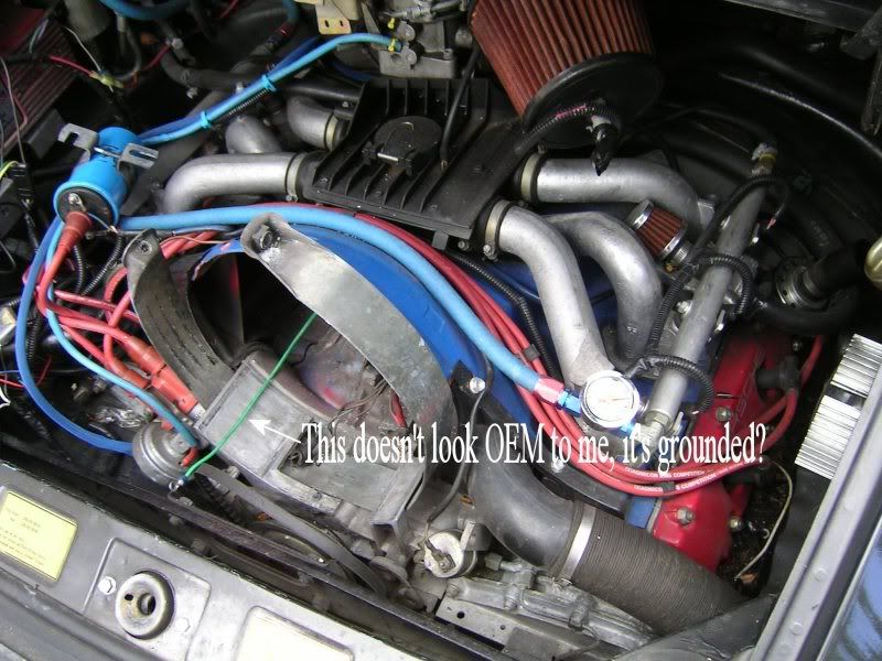

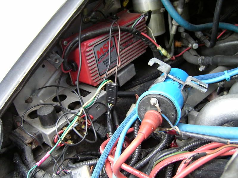

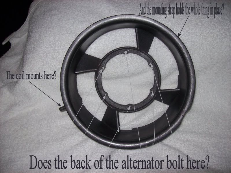

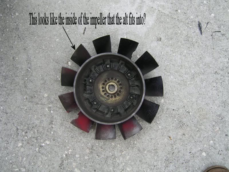

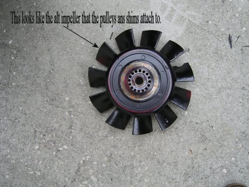

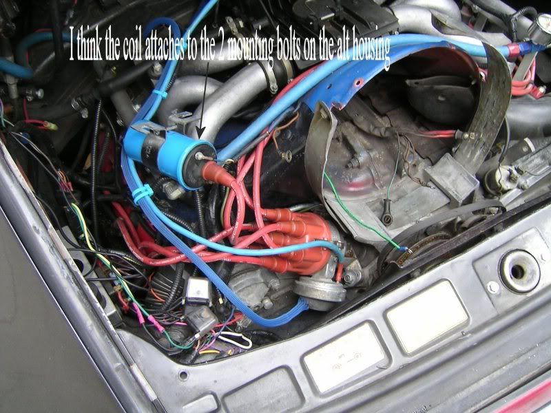

Hello, My name is Jack and my brother who I think was a member of this forum (Buster) past away last week and was waiting on an new alternator to install. I have never worked on a Porsche before but am very mechanically inclined. There is a large circular strap that looks like it actualy holds the alternator in place with an impeller attached with some shims. The coil also looks like it needs to reattached after the alternator and impeler is straped back in place. I have some wiring diagrams and photos of what I'm working with.

Remove the fan belt by using the spanner wrench to hold the pulley still while loosening the nut. There is a half-moon "key" in the shaft, so don't let that fall down under the bottom pulley.
Unbolt the strap and pull the fan housing toward you. This will allow you to access the fasteners on the back, which hold the plastic air cone thingie and the alternator. I believe they are 10mm nuts. Patience.
Then, the cool trick for getting the alternator to fall out of the fan housing is to set up a pile of rags on the floor, and set a 2x4 or two next to the rags. Bang the fan housing, upside down, on the 2x4, gently, a little at a time, moving around the housing with each tap, until the alternator falls out onto the rags.

Great, so the coil does actually bolts back on to the alternator strap.

Yes that helps alot, I'm understanding more and more now. What's the purpose of the "plastic air cone"? Insulation from the wires on the back of the alternator?
It's my understanding that there's no seperate regulator with alernators, just generators?

Coil - yes it attaches above the strap like the first pic shows
The posts on the back of the alternator are sized differently so almost one way off andback on, atleast on mine. Take a picture if you can or make a sketch and if you have multiple wires tie wrap them together. Not sure if it is a ground just happened to be the only connector with a spade.

The bracket was for the air pump which is long gone
Early alternators did have an external regulator. Yours doesn't.
The "air cone" helps guide air from your fan down over the cylinders.
The fan is press fit and just slides off the alternator shaft, it may take some encouragement.
Do a search there is a lots of good information regarding this procedure. Also, don't bang o the alternator bolts to get it out of the housing, they deform easily. You'll see what I mean.

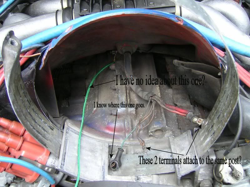

1) Ground wires are brown. Always, or nearly always.
2) The shims adjust the distance between the fan and pulley, to adjust for belt wear. The correct number of shims MUST be installed under the alternator nut. Some of them go between the pulley half and the fan, and the rest go under the "cup" that is between the nut and the pulley half. I am not clear on how many shims are required, but they all must be in there in one location or the other.

There should be six shims total. You must use all six, in any combination, until you get the desired tension on the belt.
Well that straightens out my theory of mixing brown with red wires Thanks.

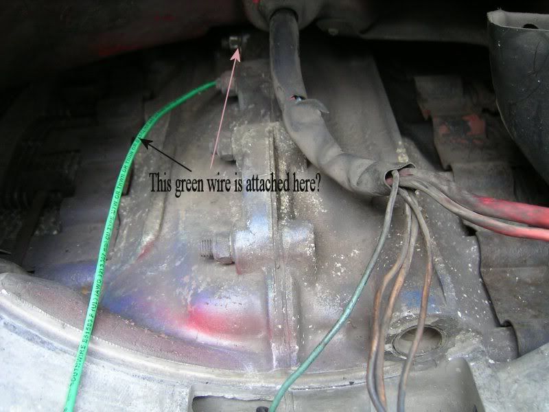

OK, Here's what I got to work with:
What a mess, huh?
Thnaks all.

Looks like the green wire was used to replace what should be a Brown ground wire. Do the Porsche world a favor and change that wire to the proper color, Brown.
I believe that the factory suggested adding the brown ground wire to ensure a proper ground.
Peace, Ron
I can do that. Thanks

Does anyone have a diagram or photo of the back of the alternator with the wires attached for reference or should it be obvious. I'm assuming the largest terminal should be for the red(hot) connection ?
