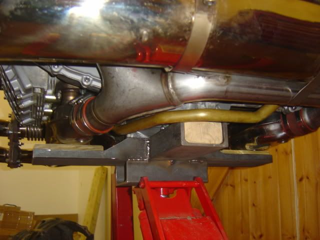

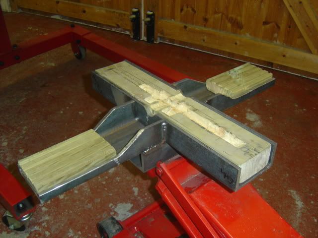

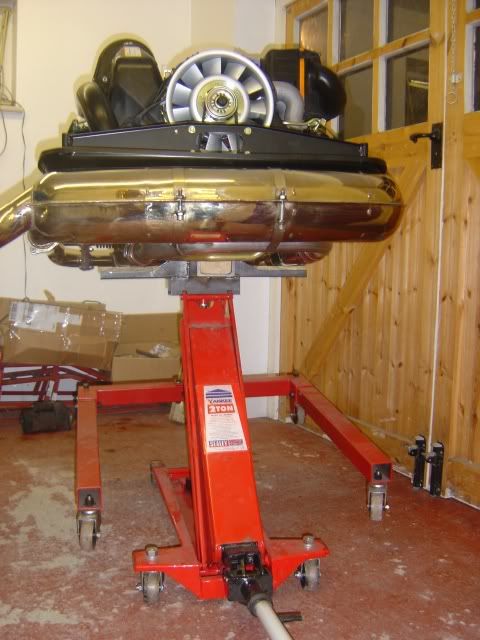

Engine Removal Platform
I've posted this previously... Here's my engine drop combo. The engine support is a 3/4" plywood platform with a 1" pipe flange, the 1" pipe nipple fits through my floor jack to keep the plywood platform from tipping over if it wanted to do so.
The engine hoists are connected to fixtures that bolt up to the wheel axles. I borrowed the engine hoists, I think I paid the local welding shop $75.00 to cut out, drill and weld up the fixtures.

Guys, several of you are putting the full weight of the motor on the SSI heat exchangers... is this ok??? That seems like an aweful lot of weight to put on these. Don't they deform? Crack? Don't you destroy the gaskets?
I really didn't think you should put the full weight of the motor on these, I thought you had to lift by the engine case?
Am I wrong here???
Old 03-13-2010, 01:04 PM
Join Date: Oct 2004
Posts: 15,612
No, the weight of the engine is on the crank case. That is what the middle beam is for. It should be slightly taller than the side support, which is there if the engine starts to lean.

Here's the platform that I made.
I think it could be adapted to a trolley jack using Mitch Leland's method even though I used an ATV jack.
If I were to give extra advise, I'd say strap the engine to the platform with a tie-down once it is lowered a little bit.
Also, use 4 jackstands to get the car level when you're dropping and re-installing the motor. This will make it easy to remove and re-install the bolts with remarkable ease.
Finally, you might want to use a second jack at the transmission nose to make sure that the shift rod clears the center tunnel without putting pressure on the shift rod. Once is is clear, begin lowering.
Credit for this design goes to Mr. Fred Cook, and the 2"x4" block supports the transmission at the point where the part number is stamped in the blocky aluminum protrusion at the bottom of the casting. This will allow you to support the engine and transmission as a single assembly, right under the balance point that Gunter mentions.
