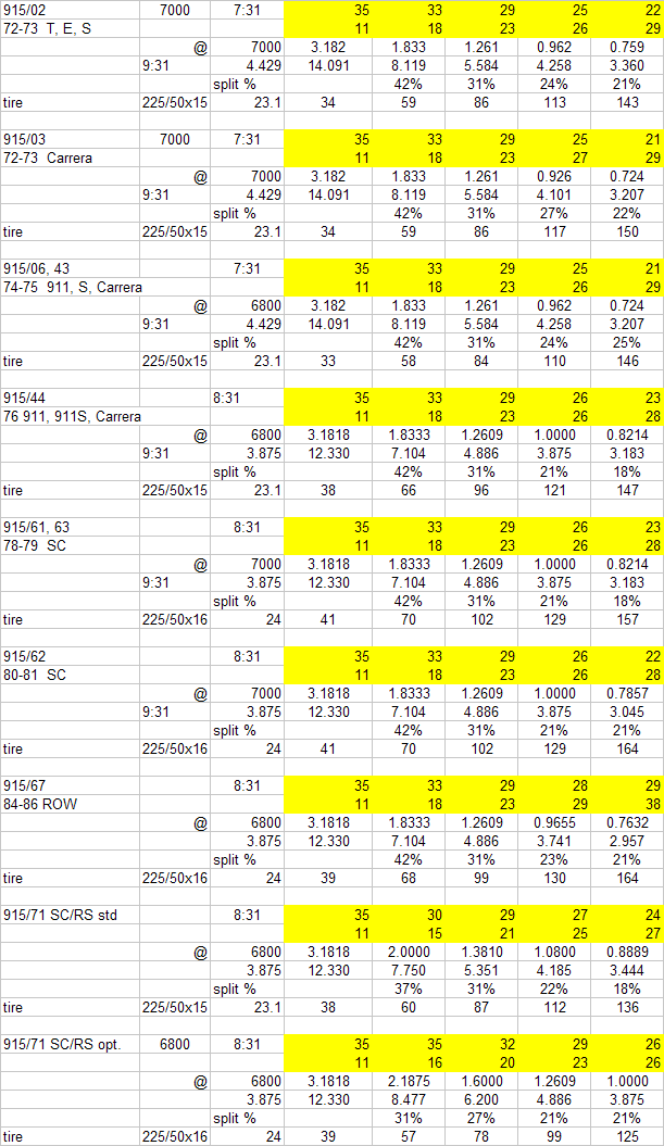

8:31 was std from MY75 up
here are a bunch of 915s , from '72 -'86, If it's not here I have it.

Thanks Pete and Bill, exactly what I wanted to see!
