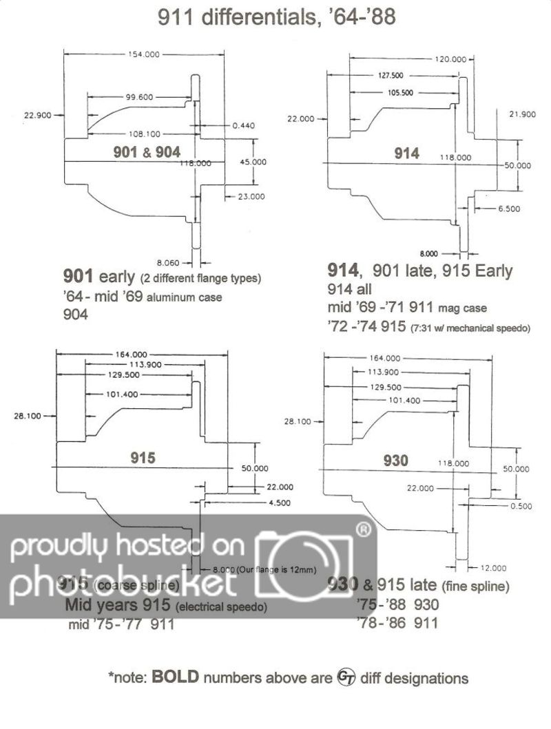

Here is some info I've collected

According to PET, the coarse-splined 923 flanges were used in 915 transmissions up through 1979.
The transition occurred either during or after the 79 model year.
See Pete Z's timeline in post 12 here...
http://forums.pelicanparts.com/porsche-911-technical-forum/548265-83-3-0l-engine-trans-swap-85-3-2l-engine-trans-axle-options.html

Good to know. I was told that the 8:31 915s were all fine spline.
So if I ever want to put a 8:31 915 in my '71, I only need to find one '79 or older, and my axles will work.

1972 - Start of production; magnesium case; 7:31 ring and pinion; mechanical speedometer; early style clutch throw out bearing tube.
1973 - Change to input shaft seal design to address service issue flaw.
1974 - Change (final) to input shaft seal design to address service issue flaw. Transmission disassembly no longer required.
1975 - Midyear change from 7:31 to 8:31 ring and pinion
1976 - Change from mechanical to electronic speedometer.
1977 – Start of transition from magnesium to aluminum case. 915/60/61 aux spring on the trans exterior, - Change to 1st and 2nd synchros, split lock before, double lock after, asymmetrically pointed teeth for 1st, smaller syncro ring for 1st stronger guide sleeve 1 & 2
1978 - Reinforced differential side cover (addition of extra ribs), nodular cast iron p/p, cast iron clutch, rubber ctr clutch, All models 5 speed now
1984 - Reduction in diameter of input shaft bearing in differential case.* This significantly helped in the reduction of problems with bearing bore ovaling.
1984 - Addition of oil pump and cooler for 915/67 & 69(RoW), 915/69 uses 930 output flanges
1985 - Improved bearing assembly, input shafts uses cylindrical roller bearing from 930(smaller OD) this was actually introduced 12/16/83 on 915/67 from trans # 915/67 02340 w/ small(100mm) cv flanges, 915/68 02192 small(100mm) joint flanges, 915/69 10081 lrg((108mm) joint flanges, 915/70 10217 large(108mm) joint flanges,
double lock gear syncros for 1 & 2, 3-5 syncros have smoothed and round end syncros(R2.5), lsd modified graphite cast iron case w/ larger holes for fluid flow and fewer disk count, only 1 ea outer and inner (also far less effective than previous lsd versions(sometimes called a 'snow belt' lsd)
all have the large 105mm joint flange
1986 - End of production
