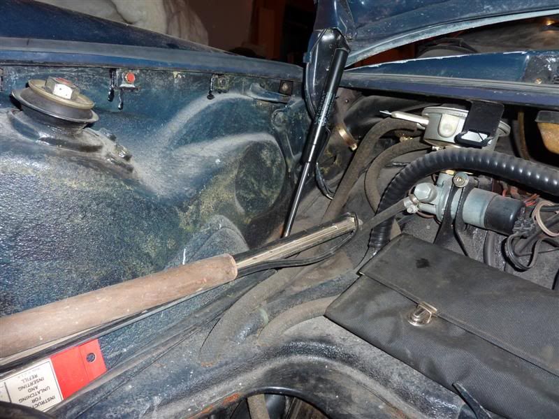

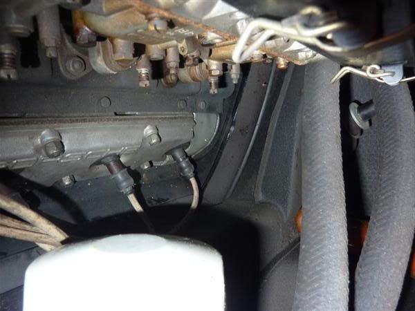

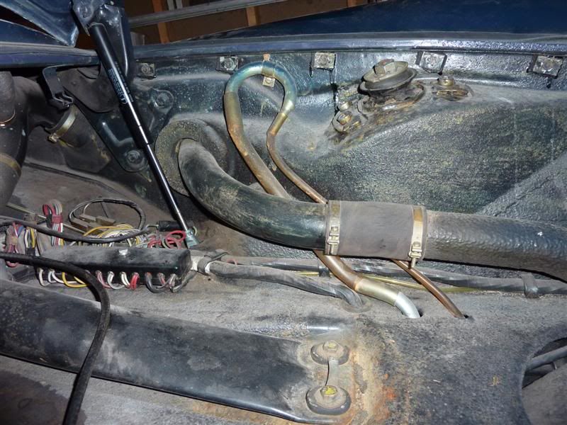

Well I met with Aaron this afternoon. I tell you I really enjoyed seeing all the cars in his shop. We got under a 70s era car on a lift and he pointed out some areas where I need to check for rust to help determine what we are in for.
When I took the pics I have, I went looking for rust and shot what I found. So either I missed it or it is not there. I'll get complete shots of the rocker panels and inside the wheel wells this week.
I am including some additional pics below.
Thanks dhagood for pointing out that a repair to a 20 year old car may not have been executed with the same care one would take on a 40 year old car simply because of the rarity. I did not think of it from that perspective, but I can see your (and Grady's) point now.
Anyway here are some of the pics I shared with Aaron.
From behind.

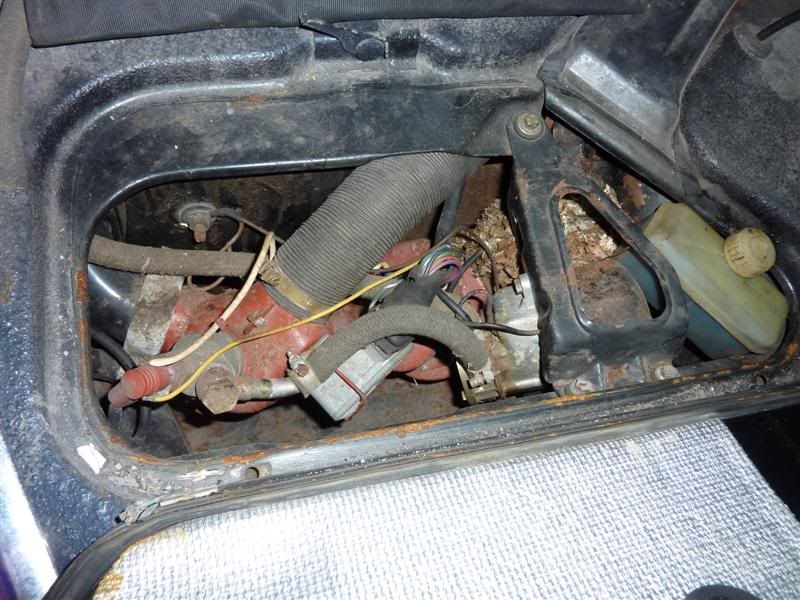

Engine left:
Engine right:
Front view. Spare parts and bits and pieces stored here. And look, the tool kit is present!
Gas heater (with mouse)
Passenger side hood strut
Drivers side hood strut. This side had the fender repaired after wreck in '75

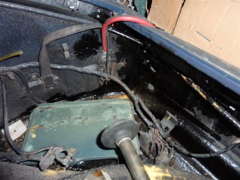

Battery box. Not sure if repairs done here were result of collision or corrosion.

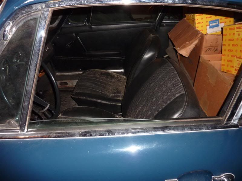

Interior. Yes, mold on the seats.

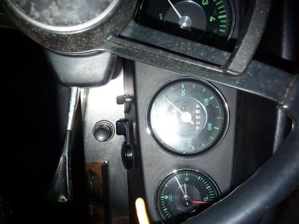

Gauges. That's 48,376 original miles.

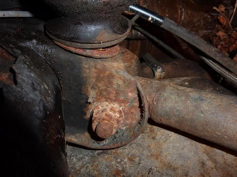

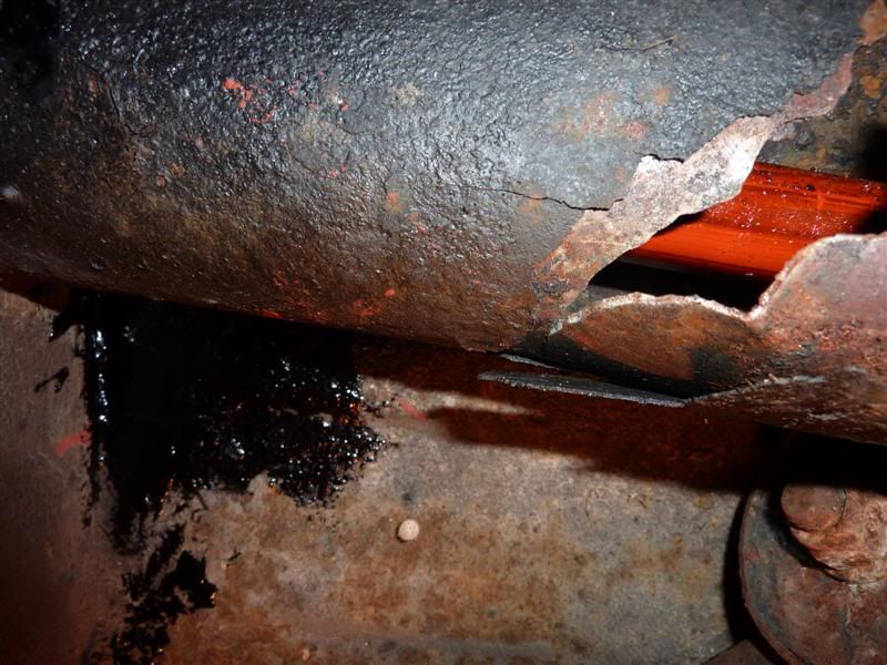

Here are a couple more shots of the torsion tube. You can see the typical rust situation on the floor pan.

not too bad!
now get underneath and take some good pics of the front tie in for the A-arm on the body
also remove the pedal cluster and post a pic of that

IF the only serious damage and impediment to driving is the damaged rear torsion bar tube
(and other components damaged in the 180 spin and consequent to the tube failure),
then get it ‘fixed’ sufficient to drive the car.
This won’t be ‘earth shattering’ expense.
This won’t be correctly or completely ‘fixed’ either.
(The torsion bar tube rusted from inside due to condensation in the ‘sealed’ cavity.
You are seeing only the rust on the outside. It is probably more serious inside the double panels.)
The spin only stressed the [weakened] tube to failure.
You will need to spend some time (and money) getting everything else working and safe to drive.
Now you have (at least) a ‘running 911’.
Now assess what you want to do.
I agree, an extensive ‘chassis rebuild’ is not for everyone (and certainly not for the impatient).
You have the unique situation having a 1-owner, Factory delivered, relatively undamaged and unmolested 1967 911.
If you simply ‘repair’ it and drive it, it will be fine for a bit but will certainly succumb to rust.
I suppose my recommendations are biased based on my 44-year observations as to ‘how fast’ a 1967 911 can go from ‘serviceable’ to ‘junk-yard crusher fodder’.
Under adverse conditions some didn’t survive two years from new (and they didn’t use mag chloride then).
You are the current caretaker of a very special car.
I would like to see it be enjoyed by your great-great-grandchildren and everyone in between.
In the end, it is your 911 and your decision.
Best,
Grady
