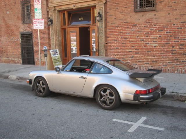

So it seems my 83 911 SC is still giving me trouble.
I added a 3.2 ROW engine (80k miles) to my car. Keep in mind the engine sat for nearly 3 years before I purchased it, but looked well cared for.
I recently adjusted the valve guides, replaced main seal and various gaskets as well as the oil, New Fuel filter, New Spark plug wires, New Cap, New Rotor.

Only to find out I had two Big but simple problems.
1. fuel pump wiring was in the wrong position + extra red wire needed to be removed
I didn't remove the old wire from the top of the fuse port and only added the lower one.
2. Fuel lines were backwards (yes very silly) this is why the car would only start with a quick start can.
After finally getting most of the wiring sorted and fuel lines swapped the car fired up for the first time on it's on. Hooray!

Seems I had two little vacuum leaks both from the same area in the throttle body rubber boot.
1. hose that goes from the Oil tank breather to the back of the throttle body rubber boot.
I plugged this with a bolt. Would Idle erratic with out it. I eventually want to add the Carrera Oil tank so I can run this hose, since I heard the engine needs it in order to not run rich.
2. small 1-2 inch hose that connects in the shape of a "U" on the same throttle body rubber boot.
(switched a new one) would idle bad when removed.
