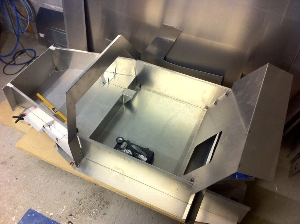

I was in the garage of a friend yesterday that has started on a 962 project.
I was impressed of his knowledge of this car and his approach to build his dream car.
The chassis will be built in the basement of his garage.
He has spent about 2-3 years in collecting enough information to start building the chassis, but would like all the help he could get.
So if you guys out there are able to help, we would be very grateful.
I see that Wayne has a great thread here with many nice and detailed pictures.
All kind of info would be great. drawings, sketches, pictures etc
Can also send to email 930owner at gmai dot com
Here is a couple of pictures of where he is at now.

Hello guys
Here is the owner of the project! nice to have good Porsche friends to help for useful information.
What is of most interest at the moment is detailed measures of pick up point for front A-arms, steering steel suport bracket interface to the Monocoque side walls. Also exact position of interface holes for front sway bar into the Mono sides. I have all details of the measures and inside reinforcements in the Mono, but are not 100% sure if I have correct measures for all interface holes regards to the front suspension.
Thank you for your interest in this project.

I have the Porsche 962 mono drawings, but it is a copy of a copy of a.. so I am not 100% sure if I have correct measurements of the threaded holes/drilled holes for front suspension interface. Your pictures displays what I am looking for, but without the measures between them and so on...
I work for a world leading drilling equipment supplier, and make of the different parts, all from sheet metalwork through moulding and software is not the big issue in this project, but to get the 100% correct measures.
Mahler9th: Yes the goal is as close to as possible, I have checked against the 120mm shorter 956.109 (or 108) owned by a Swedish Porsche guy, but unfortunately he sold this car.

hello, i am new to porsche and a new found passion for porsche. This may sound stupid but what exactly is that, that you are building? is that the chassie of the vehicle that the eventual body panels go on?
Old 09-06-2012, 07:46 PM
Max Sluiter
Flieger's Avatar
Join Date: Mar 2006
Location: So Cal
Posts: 19,644
It is a sheet aluminum monocoque chassis joined together with rivets.
