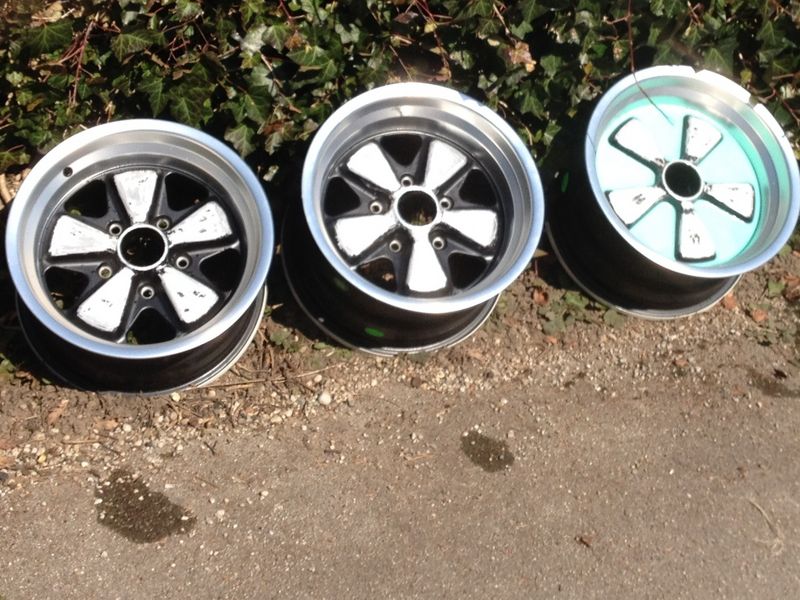

new approach for making rsr fuchs wheels.
coating, molding, blasting. lets hope for a perfect finish
not quite there jet, Monday again blasting and then they should be ready!!
