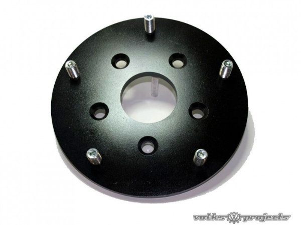

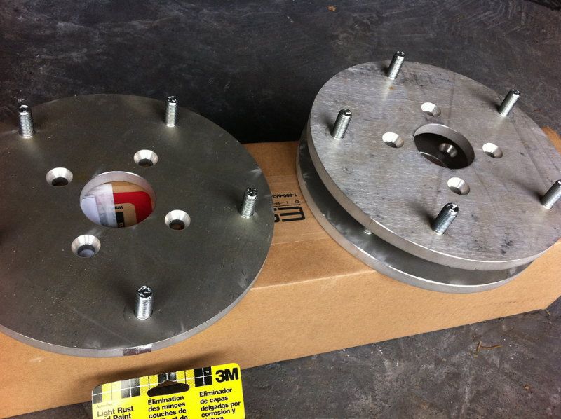

- the porsche 911 bolt pattern is 5x130 and the 356A is 5x205. adapters going from 5x205 to 5x130 are pretty common, but the reverse are pretty rare. i found only 2 sources:
the bmw uses these custom ones from the usa...
Old Skool VulcanWerks - Wheel Adapters
also found some generic ones in holland...
Adapters 5x130 - 5x205 | Spacers en adapters | Volksprojects Webshop
looks pretty sharp. just wondering if anyone has tried this with a 911? any thoughts about fitment, handling, etc? thx
