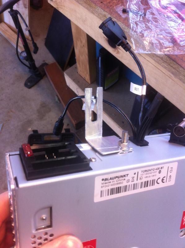

Hi All,
In progress installing a Blaupunkt Toronto 420 BT radio, I was hoping to get feedback on a few questions.
FYI - 1988 Carrera Coupe W/O Audio Pack.
  • Has anyone had any interference issues with the stud on the rear of the radio? Mine is fouling on the spot welded bracket right behind the radio, I was planing on trimming the stud with a dremel.
  • Is the DIN cage sufficient to mount the radio, has anyone used the stud in addition to the DIN cage to reduce squeaks and rattles?
  • Any suggestions where to tap for the illumination input?
Thanks All,
Rob

Rob,
Once you remove the locknut the stud will float. That should get you enough clearance. There's no need to push it into the head unit completely.
Best, --Peter

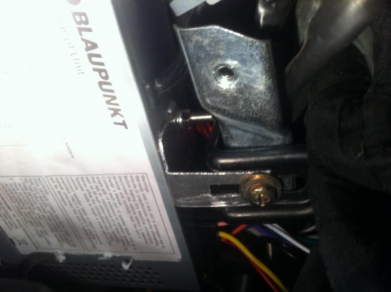

Hi All,
I ended up trimming the stud a small amount so that it wouldn't rattle around. Furthermore, I wasn't happy the din cage retention (allowed too much movement) so I made a small bracket which fixed to the stud. Check out the photos below:

Great idea man! I need to do this to mine
