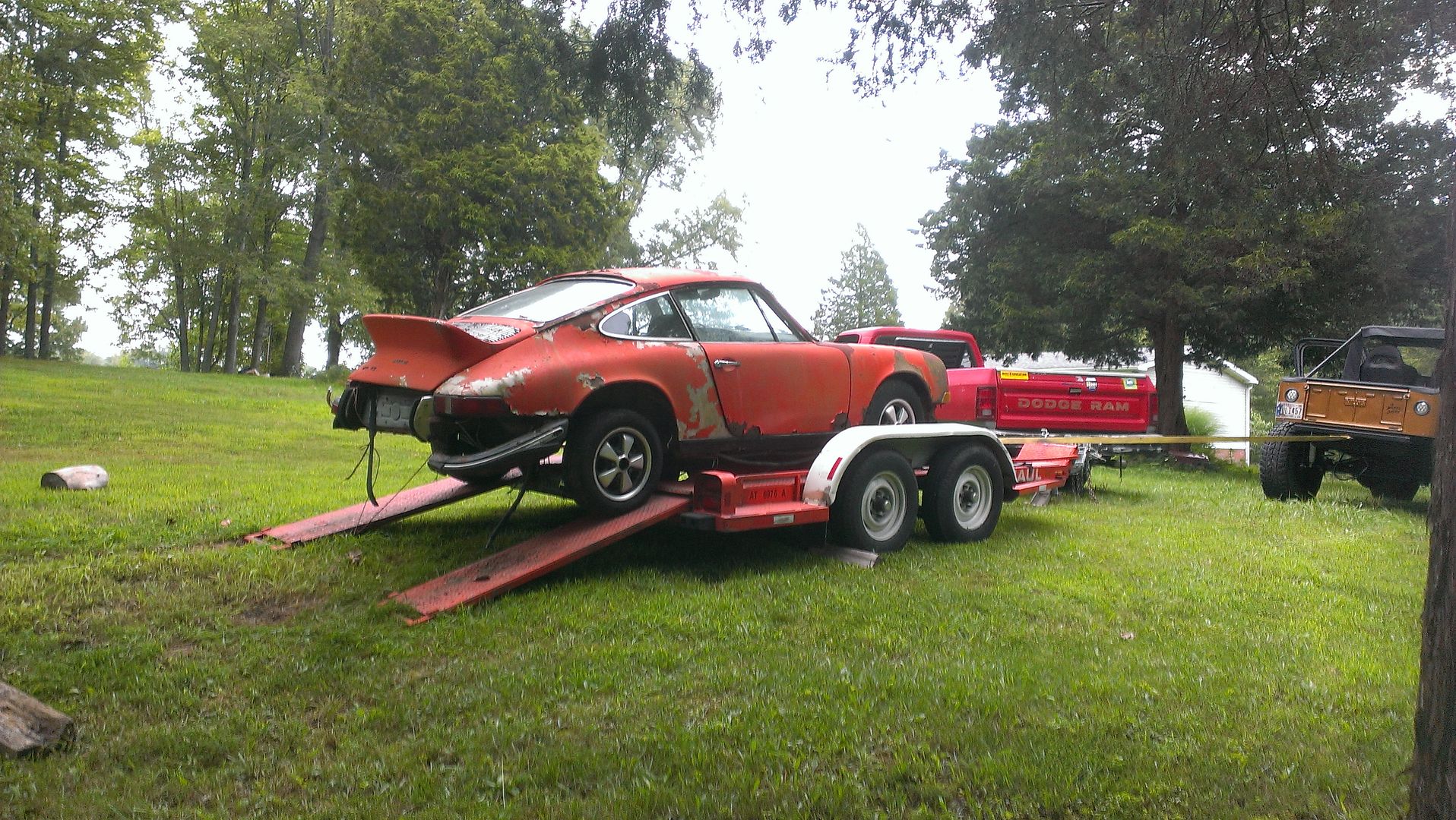

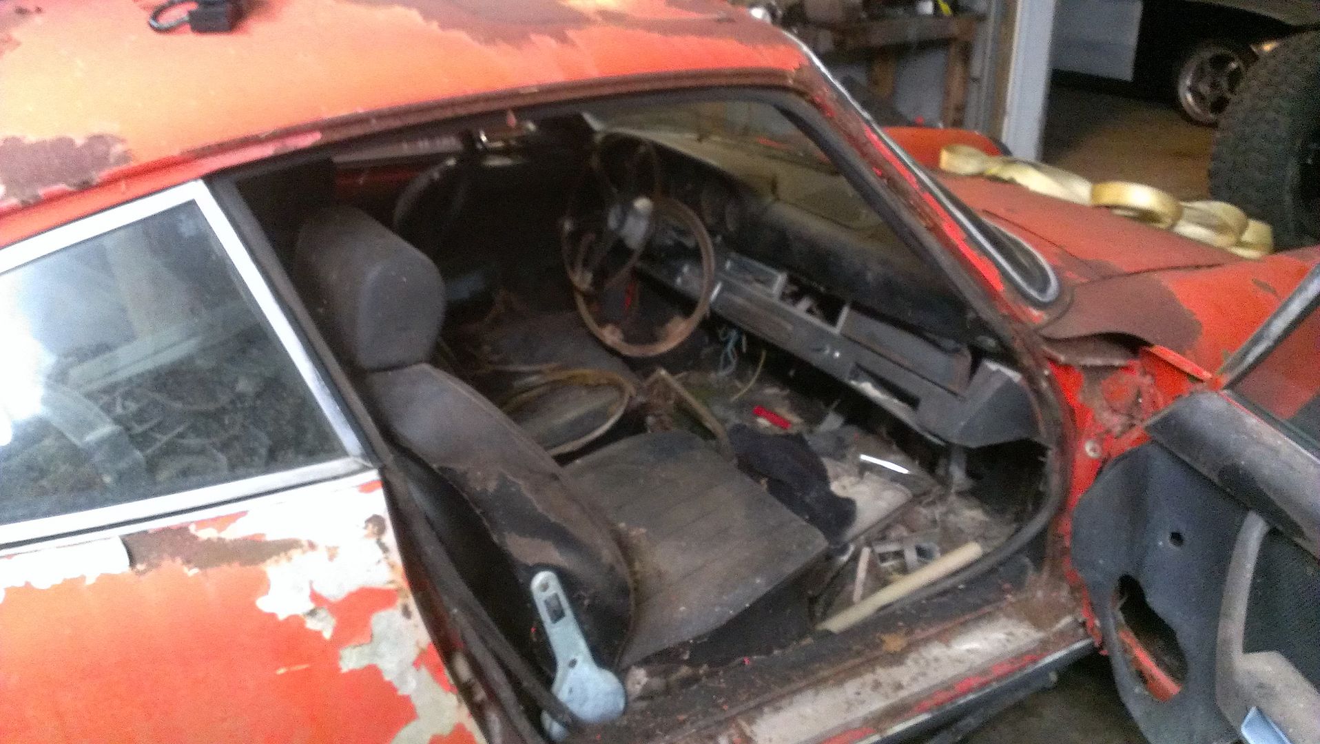

Loving the optimize in here! I don't know what I'm going to do with it yet. However I plan on stripping it down clean it up and box up the usable parts. Then I will make a list of what needs replaced, what it will cost to do so, then I will see whats missing and make a list. Then add up the cost of everything. Then compare it to what it would cost to start with a cleaner tub.
With that said coming out of left fled, My original plan when I was looking for a 911/912 was \to build a RSR style restomod. I wanted something that I could cut up and not worry about it. I planed on making this car a year around DD, I have no plans on restoring it Sorry to all of the porsche purest. Its to far gone... That said I still think it maybe a good start for what i'm planing on doing to it. It will be a franken porsche of sorts, I will be using 996/997 c4 suspension and drive train. I have not decided on an engine but it will probably be water cooled. I will possibly use a miata floor pain and trans tunnel I have not taken any measurements. I am a fabricator by trade so all metal work will be easy. My main concern is the roof the rest of the tub does not bother me. I plan on caging the car and deleting the sun roof. However the windshield frame/ wiper panel is rather bad and may need to be replaced rather then patched up. So do I go with steel or fiber glass? I will go with fiber glass panes but I think the doors and roof should be steel. As I would like to reuse all of the glass.

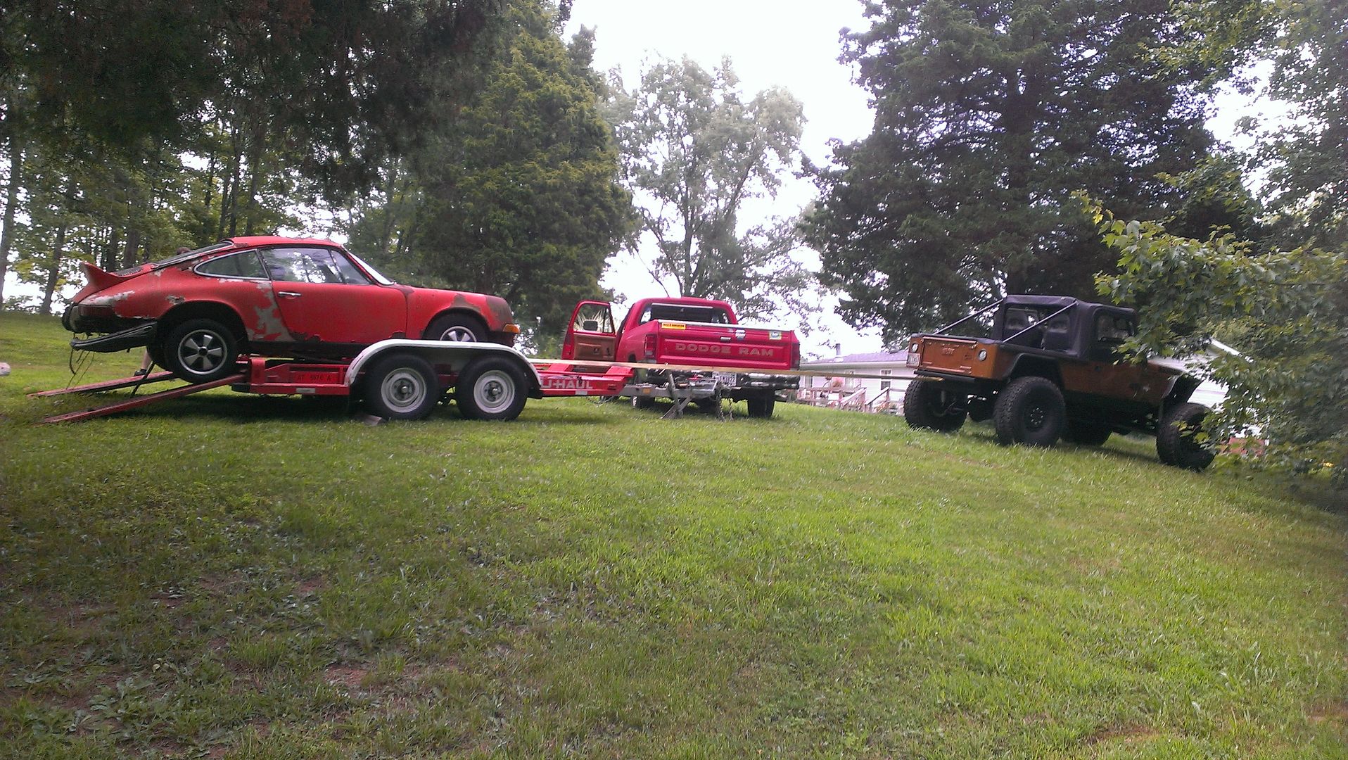

I pulled to of the wheels and put a set of miata tires I has laying around on them to help get the car on the trailer.
Little did I know one of the rear wheels was locked up and had to go back to the house to get the jeep to pull it on as the hand crank was not enough for the job. Thankfully the car was on 20 min from me.

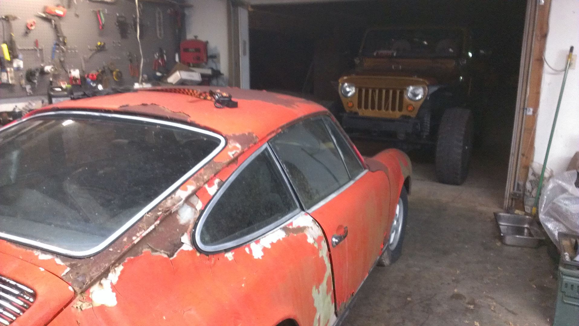

and its home.
The jeep looking pist as the car is in its spot.

Thanks it is, I bought the car because it was in such bad shape, I just can see my self cutting up a good car. As for glazed Its a thin cote of body filler.

Immediately remove all body panels, hood, trunk, doors any thing loose have it media stripped and have them stripped and epoxy primed. Remove front rear suspension, steering rack etc take them to sandblasted. Remove everything from the car and have the shell media blasted and primed. Them begin
This is part of the plan I will hopefully start striping it down this weekend. I have been searching C-list for a good media stripper.
Originally Posted by Porboynz View Post
Some of the suspension mechanicals and the remaining glass looks OK but that body looks severely race lightened to me. Make sure your head stays in charge.
I don't thing it was ever raced other then maybe on the street. And I will try.

I'm with Typ616. Check the VIN. Its got vent windows (pre-69), and the door handle looks like the early style (pre-68). Cant tell if that's a smashed battery box hanging under the LF fender, or not. Side mirror is '72 and later.
I know guys get excited about finding just about any old P-wagen these days, but I can't help thinking some of them should just be left to die in peace.
From the looks of it, it has a lot of different year parts on it I have not looked for the vins yet i'm still waiting on the PO to fill for a lost title.

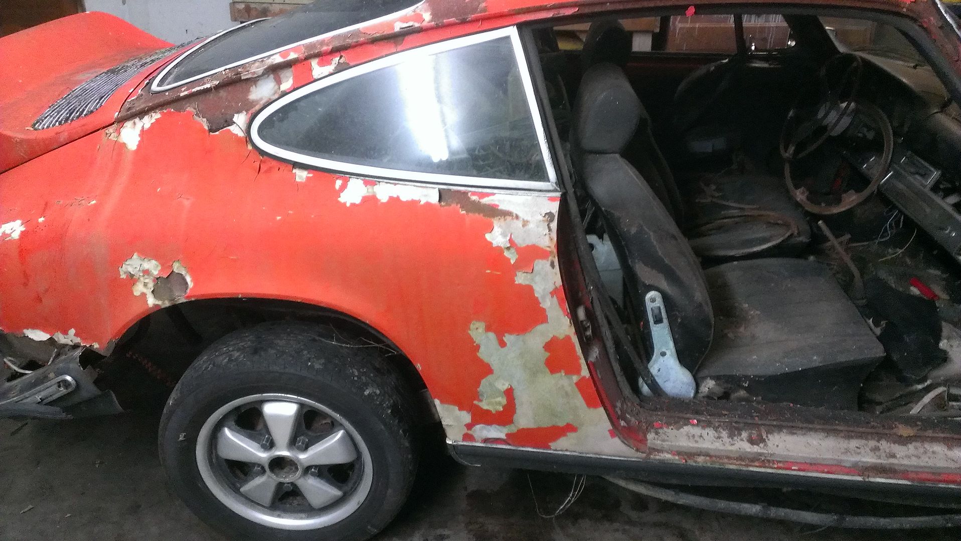

Thankfully I will not be needing the rear seats.
Richard Newton
Exhaust System Material
Originally Posted by Sunroof View Post
Rear seat buckets are infamous for rusting on the longhoods. Water weeps down the rear window channel and makes its way under the rear seat into the bowl and just sits their and eats away. Add the wire retaining clips underneath and that spells more danger. This of course happens over decades.
Yours is not all that bad.
From what I can see from the under side of the car it not to bad.

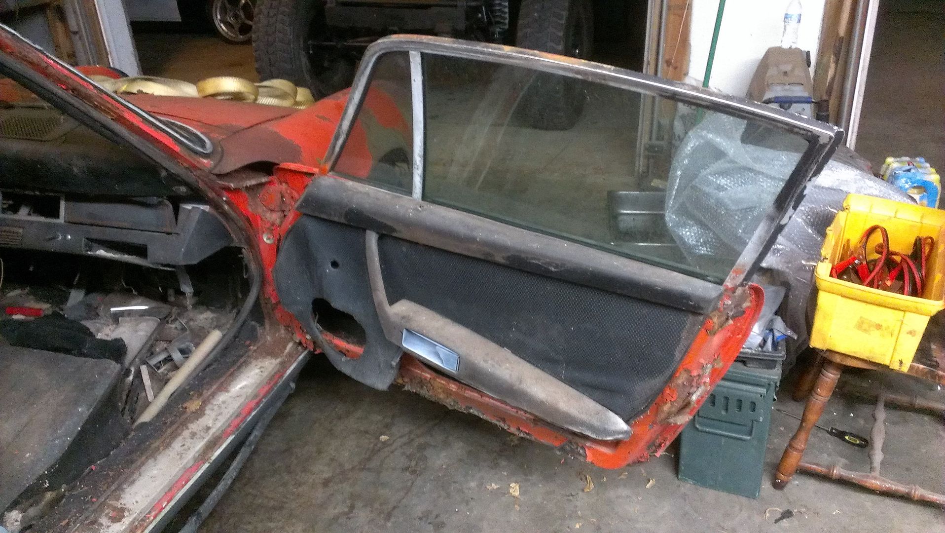

Just saw the pictures inside the garage. Doesn't look quite as bad as in the yard. I'm sure you got it for a good price. If the underside isn't too bad you might be surprised what someone would bid for a restorable E shell at the 'bay auction site.
