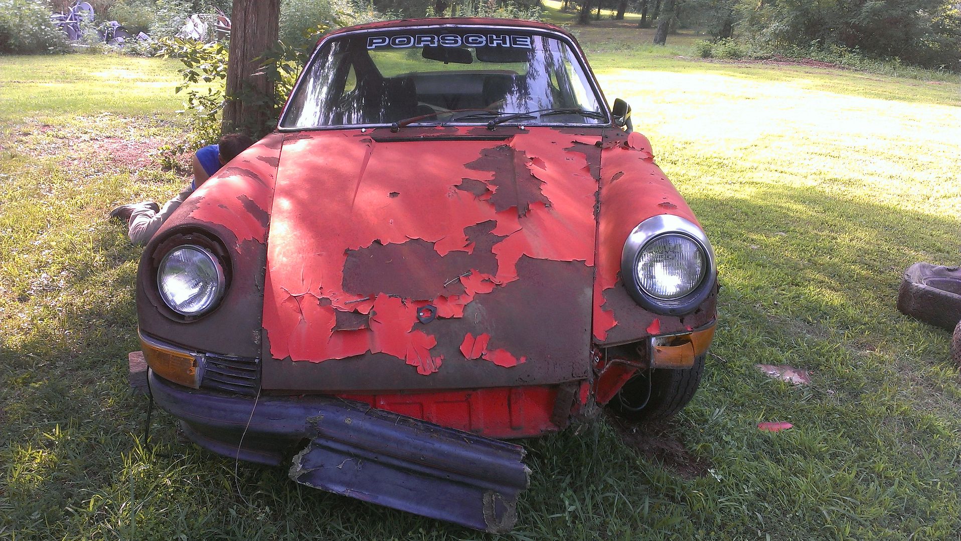

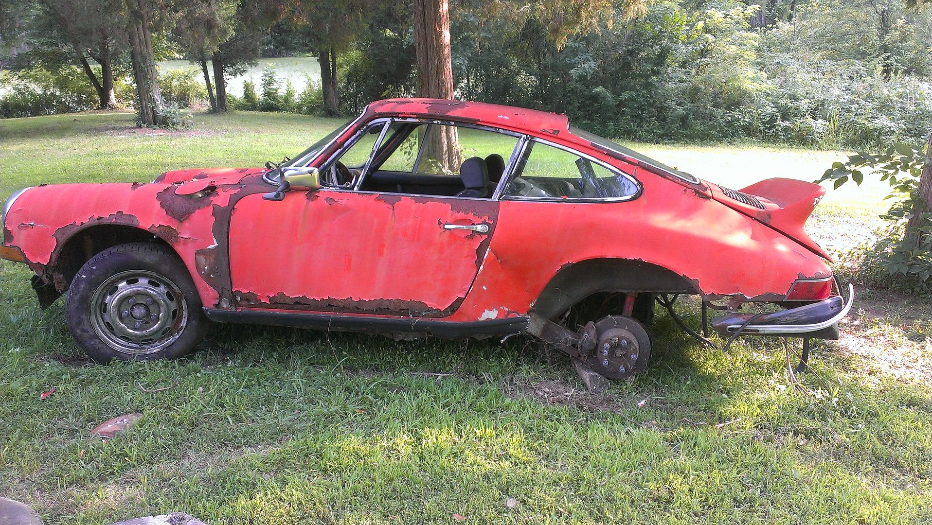

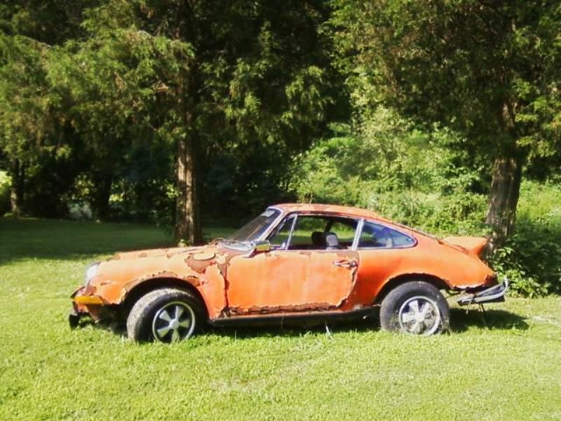

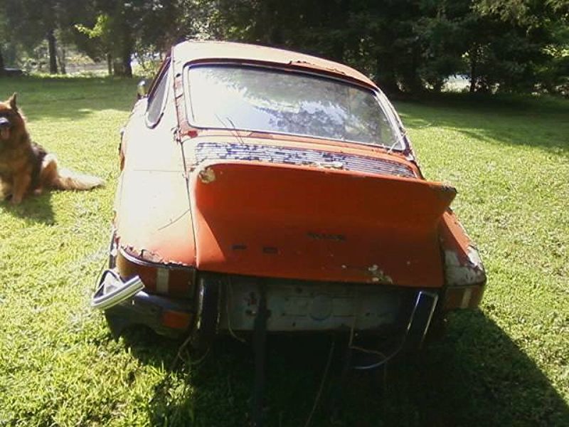

I don't know if this is the appropriate place for this thread. But i'm picking up a 1970 911E sometime this week. It has been sitting out in a yard for 15 + years. The engine and trans where pulled and rebuilt but never re installed. The trans is in the back seat and the engine is missing but if found will be coming with the car. The car is in ruff shape (ruff is putting it nicely) The car was repainted in the mid 80s and from the looks of it the entire car was glazed when painted. The hood is trashed the passenger front fender and quarter panel maybe salvageable. The floors from what I can tell are not to terrible but they have the usual rust spots by the rear suspension. My main concern is the roof and front windshield/ wiper panel has a lost of rust I don't know the extent of it yet.
A few pics I meant to take more, but I was trying to get the wheels off to have new tire put on to make it easier to load up some time this week. ![]() ![]() ![]()

I don't think it is possible to save much of anything on that car. Good luck.

Immediately remove all body panels, hood, trunk, doors any thing loose have it media stripped and have them stripped and epoxy primed. Remove front rear suspension, steering rack etc take them to sandblasted. Remove everything from the car and have the shell media blasted and primed. Them begin
Some of the suspension mechanicals and the remaining glass looks OK but that body looks severely race lightened to me. Make sure your head stays in charge.

I don't think it's "economically reasonable" to save that car, as opposed to starting with something in better shape...
Side note: The rear torsion bar hole seems mighty close to the rear fender opening, for a 70 ( which should be LWB). Then again maybe it is because the fender edge rusted off... Check the VIN ? Last edited by Typ616; 08-06-2014 at 05:19 AM.. |

I'm with Typ616. Check the VIN. Its got vent windows (pre-69), and the door handle looks like the early style (pre-68). Cant tell if that's a smashed battery box hanging under the LF fender, or not. Side mirror is '72 and later.
