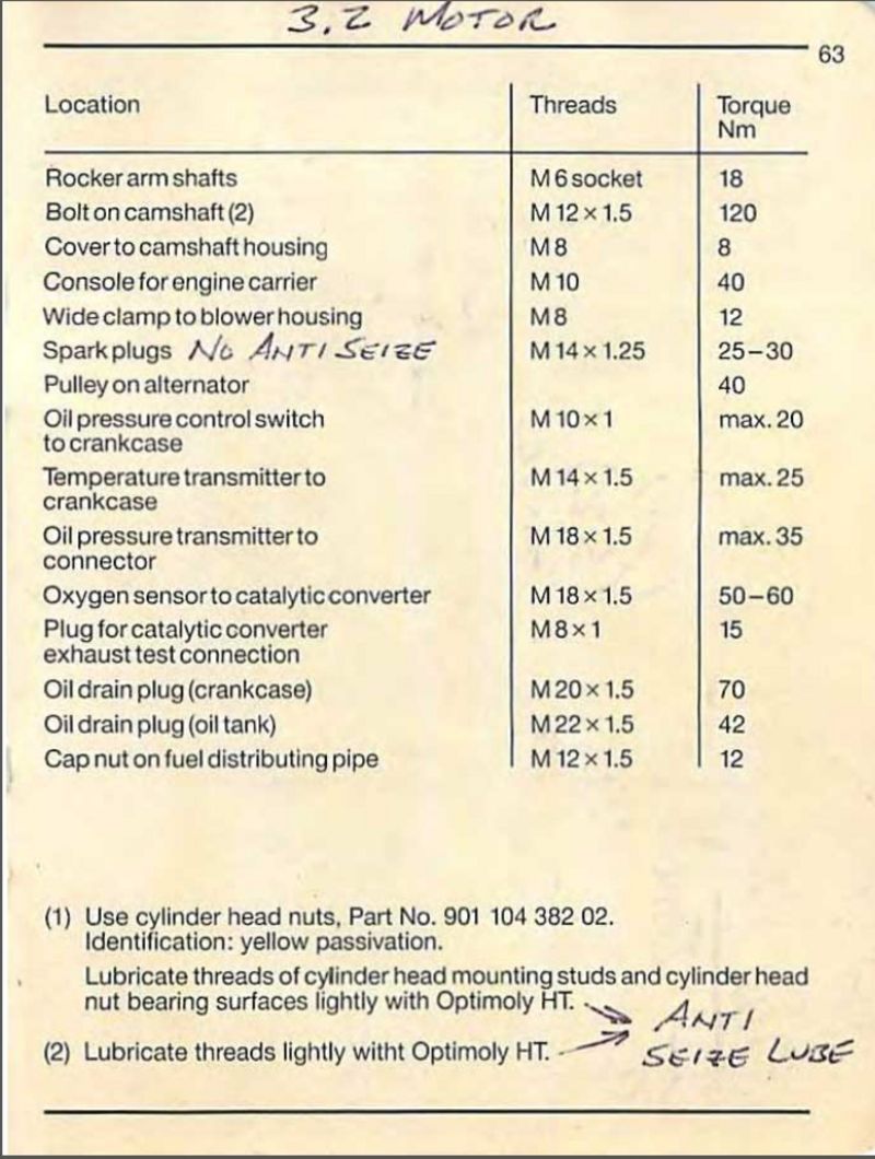

Factory spec is dry. Taken from '84-'88 technical spec book which mentions other fasteners like the head stud nuts and camshaft bolt using Optimoly HT (anti-seize paste)

Outstanding. Just took a pic of my 3.0 spec book with my cell phone. Can't send it. Weather?
Says about the same thing. I will resend pic to my e-mail on the way home and post.
If not. Tomorrow with a regular camera.
