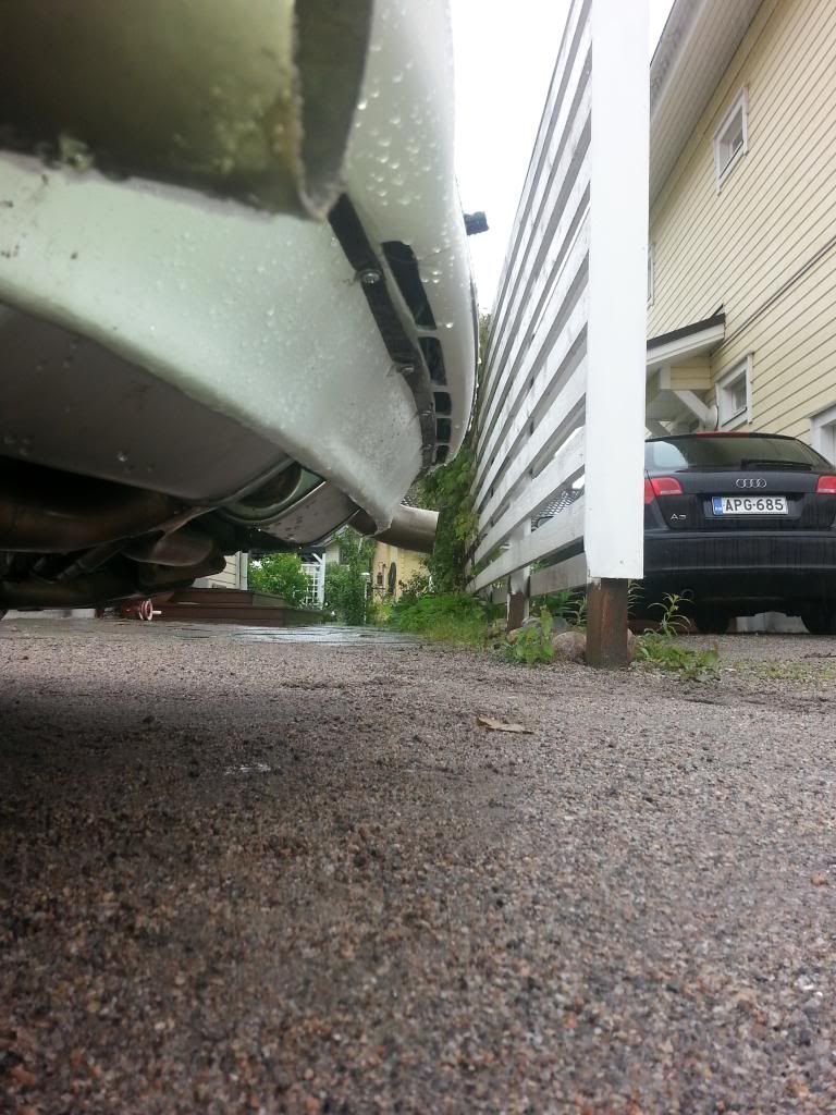

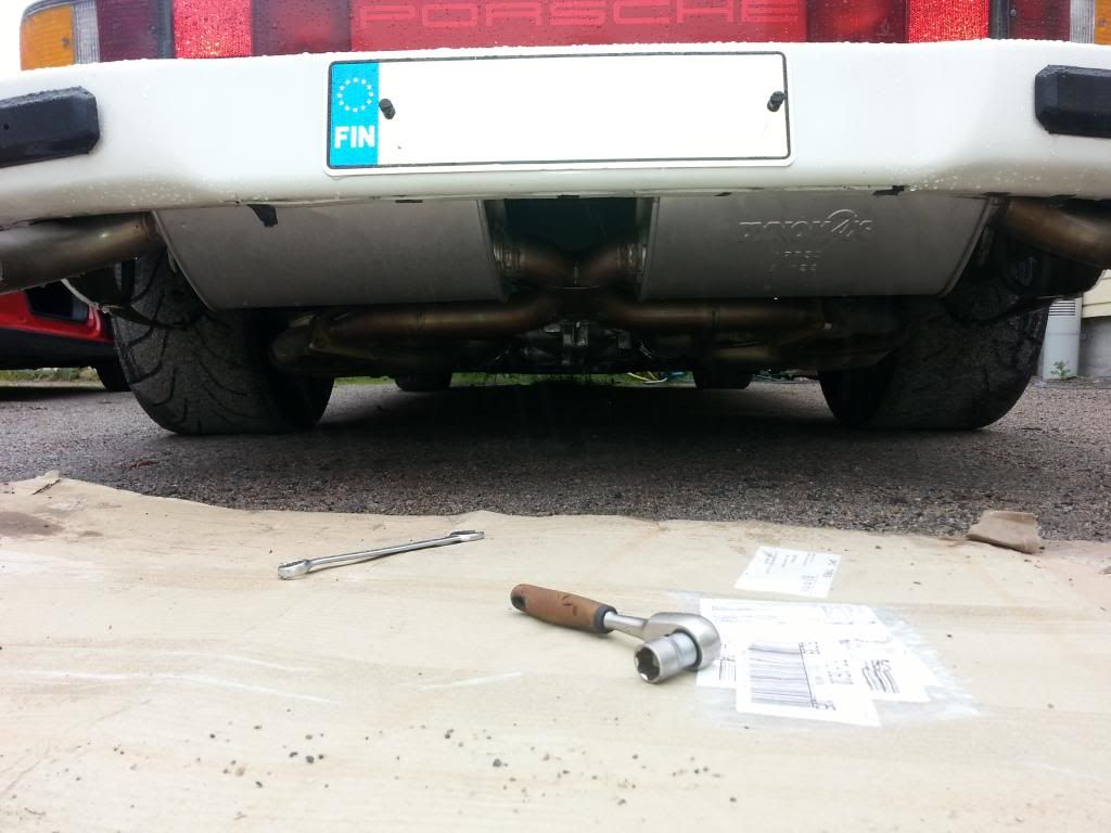

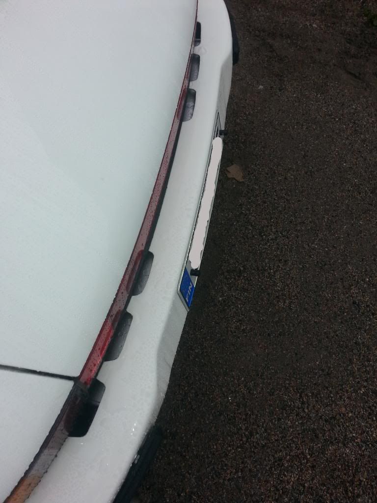

I did some cooling vents for the hot muffler in the rear bumper. Im trying to keep the appearance clean, thus this kind of solution:
911-87 mit der 3.6 V-Ram und alles spaß

That's quite a neat solution as ever Jaskas. Must have been fun cutting the ally bumpers, they're really quite thick!!
I also coated the inside of my bumper with space suit so will do the same again but cut out the numberplate section.
