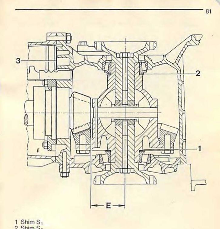

So it appears from the PAG diagram it should be flush.
Now I need to check why one flange is deeper than the other side, note mine is a LSD but that should not make a difference

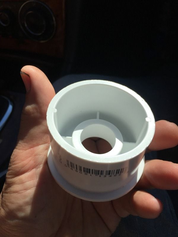

That is how I did it too, YES, ouch, smashed my fingers several times
So, I visited HD and found a SST for the install instead
The OD of the seal is 2.7 inches
This coupler's OD is also 2.7 :-)
Label is 2 X 3/4 PVC
I will use a large washer and Diff bolt to "arbor" like press it in.
Too close for comfort so I will shave/sand the PVC down a tad so I can get D-side in the depth needed, if it won't fit on the diff easily

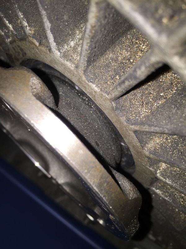

Wouldn't you know it, the bolt is too short ok back to finger smashing time :-o, actually not, because of the height of the HD SST, plenty of room as not smash the fingers with the rubber mallet
Seals All Good
P-Side
D-Side
1MM Gap from seal surface both sides

It was built by Peter Zimmerman and he stated he used oem LSD. Yes, I can concur, the P-Side (as one is seated in the car, right side) flange is definitely positioned outward further than the D-Side.
The diff plate for the D-side, I noticed is definitely has a recess/concaved then a lip to accommodate the seal vs the P-side lip which is flush with the diff case surface.
My main worry was the D-side flange rubbing against the seal, which is not a good thing at all.
So now I have matching gaps on both sides. Will keep an eye on them to insure no leakage, since i have the gear box out I could always take proper measurements using a straight edge.
