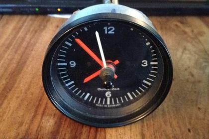

The analog clock in my '74 only works intermittently. Can't tell if it's just steadily losing time or coming to a complete stop at times, but I believe it's the former. Any suggestions on what parts might be sticking and need to be cleaned?

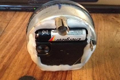

Hi Boys..i have to share this one with you.
Friend on mine bought last year 911 and when he showed it to me one of his complains was, the clock is not working..So i said no problem i will fix it for you.I did not know it would just take to fix it double A battery....;-D
Ivan
I did get him the correct clock and kept this one as a souvenir
