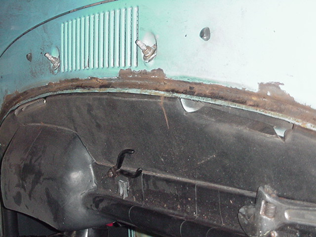

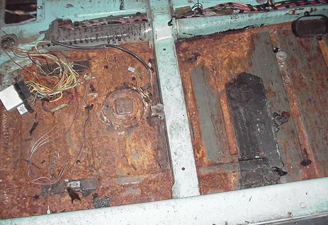

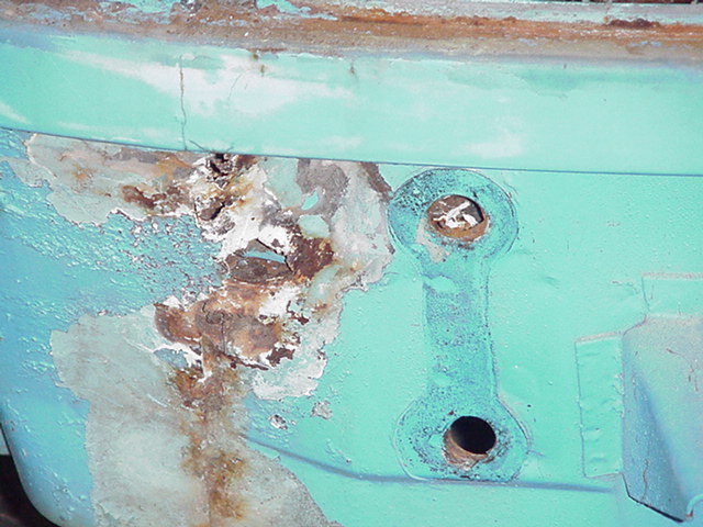

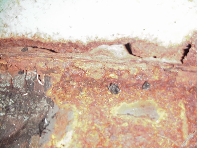

Location: St. Pete FL
Posts: 75
alright heres a few pictures of the main areas, its a big pain in the butt. How do you all fix the rust, i think right now my father and i are cleanin it up with a fine sander type thing, putting the rust acid on it and cleanin it till its no more, then fiberglass it, is that correct? Also take a look at the floor pans, its the passenger side, what do you guys think, i should prob buy new floor boards huh? I guess my biggest concern is that one picture where its like the running board or whatever you call it, its rusted pretty bad, what should i do?

how bad is the rust? like is the metal pretty thin or is it just surface rust? If you have to put fiberglass on the stuff you should probably just weld it up or get a new piece. Use a rust killer, such as ospho or what everyone loves on here, por 15. I use ospho just because it's cheap and easy. On the floor pan just clean it up and I like to use hammerite on it, but others use por 15 or other things. Just make sure when you clean up the rust you make sure you got everything....or else you'll be fixing what you thought you fixed in another 6 months. On the exterior stuff I like to shoot a coat of etching primer and then clean it off and just use a skim coat of filler to fill all the little dimples left by the rust. Then primer and paint like normal.
