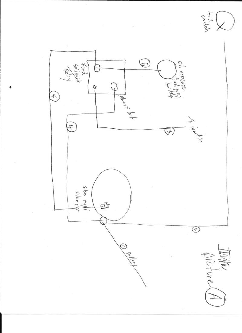

Hot start relay wiring.
Originally Posted by philinjax View Post
rcrgrl,
First, check out your hot start relay wiring against this drawing.
Phil
Phil!
I think you may have hit upon something in my hot start problem. According to your diagram and mine (as copied from what I observe of my wires), my hot start relay has been wired wrong. Check out my diagram? It appears as if someone placed wire 1 and wire 2 to the starter thus not achieving the relay hot start. Would not wire 1 be omitted entirely and wire 2 (from the kill switch) go to the relay?
D
