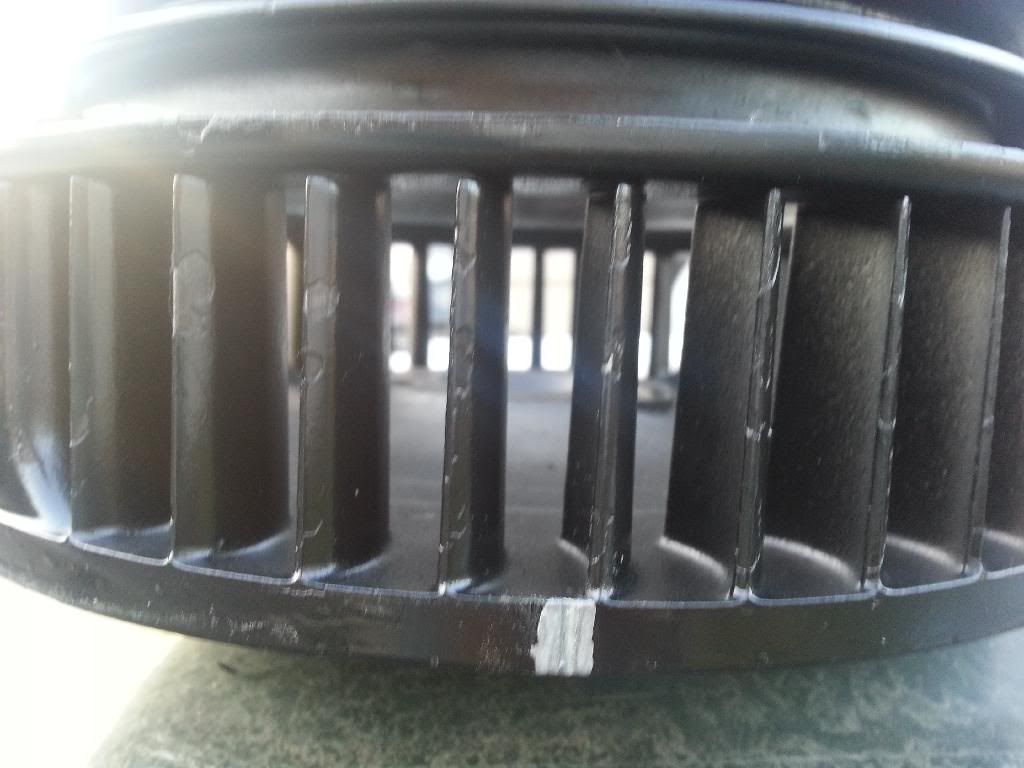

I decided to do one cylinder at a time which at this point means I only have the #3 rockers installed. All the other cylinders do not have their rockers installed. Is this a problem? Should I install the rockers for ALL the cylinders before I get started?
I put my #3 cylinder at TDC using the Flywheel notch as my TDC indicator and then scribed the impeller.
After installing the rockers I realized that I didn't have clearance between the adjusting screw and the valve. I didn't measure them when I removed them so I don't know if the was a problem before removal.
Any help would be much appreciated... I would really like to be driving my car this weekend.

You may find that your adjustment at the fan's TDC mark is for #1 cylinder TDC not #3 TDC. Remember the engine rotates twice for a complete cycle. (four stroke motor).
I suggest you take a look at the distributor rotor position, at TDC the rotor will be pointing to either #1 or #3 spark plug wire on the cap, rotate the engine 360 degrees and you will find that the rotor is now pointing at a different spark plug wire in the cap.
alternately you can stick a soft wood dowel (like a pencil) in to the spark plug hole of #3, and determine if #3 piston is indeed at top of stroke when fan indicates TDC, if it does not show the piston at top, then rotate the fan 360 degrees and see if #3 piston goes to the top.
remember it takes two rotations of the crank shaft to give one rotation of the cam, and distributor. you have to pick the correct TDC in order to adjust the valves. By only relying on the fans TDC mark, you have a 50-50 chance of hitting the correct location of valve adjustment, that TDC mark is the same for both #1 and #3 TDC.
for #2 and #4 TDC the fan mark is not factory included, but will be 180 degrees from the #1 and #3 TDC fan mark.

So I got this sinking feeling in my gut after reading through several horror stories about sunken valve seats and broken valves.
I just couldn't believe I had been driving my car this way and recalled that the first time I pulled the motor about 3 months ago I didn't have this issue and I only ran it for about 10 minutes before pulling the motor again.
I used a long screwdriver to nudge the exhaust push rod of the #1 cylinder and it popped into place. I would have sworn up and down that I had the push rods seated perfectly before trying that. They were straight from the rocker to the lifter and I had confirmed with a flashlight. I then torqued the nuts and did the valve adjustment for all cylinders.
I was not comfortable with my valve adjustment work the first time a couple month's ago but having gone through the motor a second time I learned a lot about TDC and valve adjustments. I am very confident about my work this time around.
Although I read that the #1 and #3 valves have the same TDC and can be adjusted at the same time I did not find that to be perfectly true for my motor. The same was true for #s 2 and 4.

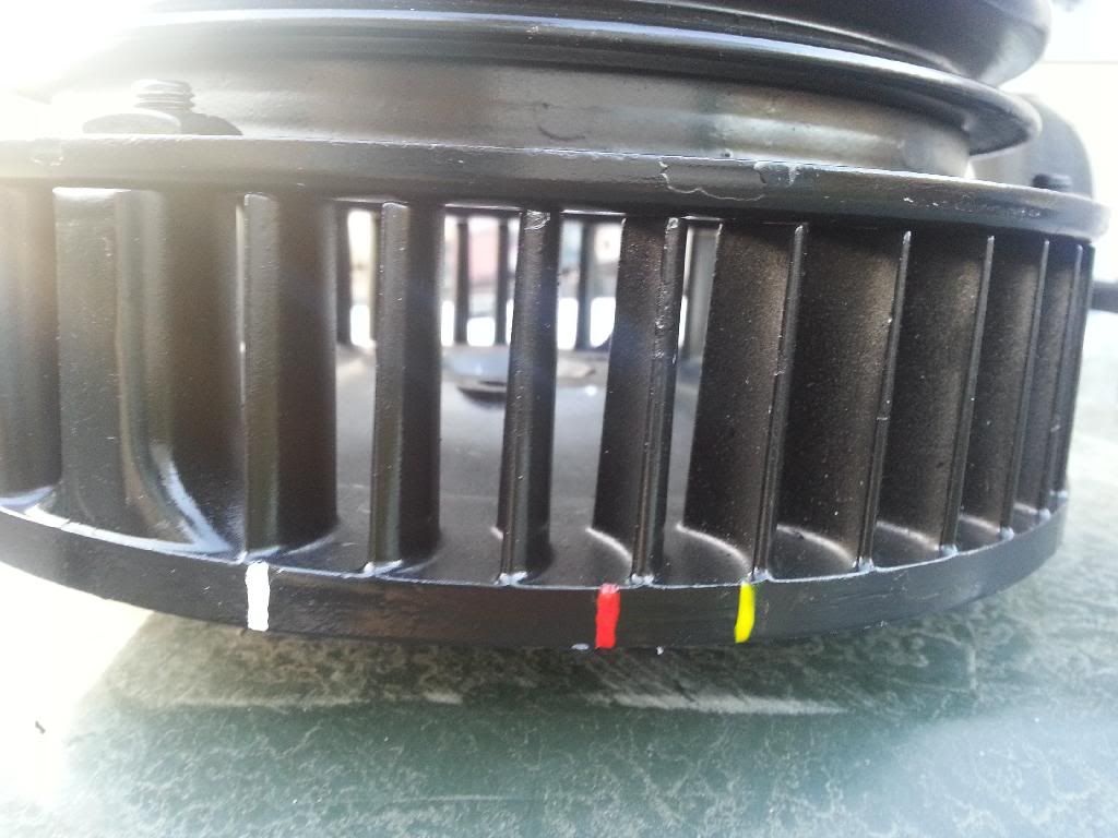

My impeller had 2 notches but neither was TDC. One appeared to have been colored red at one point and I don't recall if I had painted it the last time I did the timing over 6 years ago. I found TDC for the #1 piston and filed a notch. I also put a notch in 180 degrees from that for my #2 & #4 TDC's. I painted my new TDC notch White, repainted the Red one, and the uncolored one I painted Yellow. I painted my new #2 / #4 TDC notch with a wide band of Silver. I did this because I thought I might confuse a dirtied white #1 TDC with a silver #2 TDC.
Thanks Joe and Cabinetmaker for your inputs.
Lapping cylinders to the heads and case is exactly that. I removed the cylinders and used fine valve lapping compound to grind the surfaces to be perfectly matched to eachother. I did not use gaskets as per the service bulletin and all the fine advice on various boards. I had leaks previously which is why I had to pull the motor a second time. The cylinders are perfectly sealed now against the heads and case.
Before re-installing the motor the first time I also filed the tops of the heat-exchangers to be perfectly flat and level to each-other as well as the flanges on the other ends and the flanges on the muffler. At that point I think that my exhaust leaks at the cylinders became more serious and evident as there was now only the cylinders for exhaust to leak... but now those leaks are closed off too.

I think placing more marks on your fan is going to complicate an already simple procedure.
Rotate until TDC and watch the rotor, it gets you close enough to observe the valve train and verify when both valves are closed.

Points well taken. However the only mark that is truly new is the #2 & #4 TDC. My TDC was missing altogether.

I think there was some confusion about the #1/#3 thing.
The crank (and therefore the fan) turns twice for every one rotation of the cam. So when the "TDC" mark is at the top, you can either have #1 or #3 at TDC, ready to be adjusted. Not both at the same time. And #2/#4 are similar.

John, I used a hybrid of all the methods I thought made sense. The paint brush handle I used for painting on Curil T was my dowel. I turned the impeller clockwise until I felt TDC. If I passed TDC I went around again twice. I wiggled the rockers and confirmed that they were the most lose when the dowel (paint brush handle) was at it's highest. This and the notch in the flywheel helped my final8ze my TDC mark. I experemented many times before coming to this final approach.
For those who attempt this method: ensure your dowel is long enough to not fall in the spark plug hole as John mentioned and make sure you guide the dowel so the piston does not catch it and break off inside.

A hint on the fan.... paint the entire fan blade to mark the timing marks, you will appreciate a big colored fan blade once the motor is installed and once the fan gets dirty. A big colored blade is much more easy to find that a tiny mark painted near the scribe marks on the edge of the fan.
Every engine I put together gets the entire blade painted, makes timing and valve adjust so much more easy as you can find the mark in low light and you don't need to crane you head in an awkward position to get an initial sighting of the marks.
