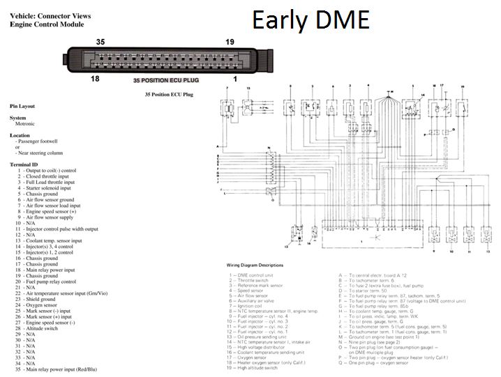

See this blade-like connector? This is on an late wiring harness.
The early cars have a rectangular connector in this same location, very close to the DME connector. This connector needs to match up to whatever is on your interior wiring harness.
PCA Instructor: '88 951S - with LBE, Guru chips, 3Bar FPR, 1.3mm shimmed WG, 3120 lbs, 256 RWHP, 15 psig boost

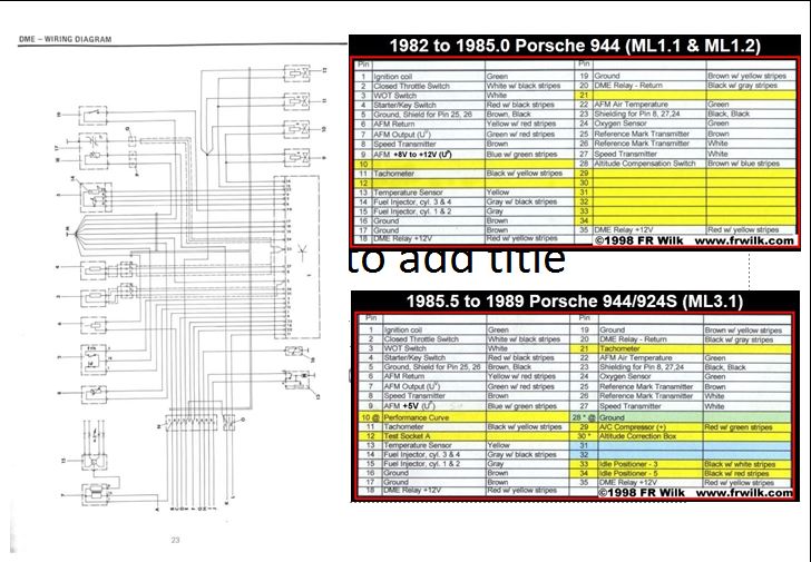

Looking inside the dme plug if I have read other posts correctly it is pin receiver 21 which is the tacho
Pin. This actually looks like the pin receiver hole is empty, other holes have a metal connector inside but not this one. Is this right?

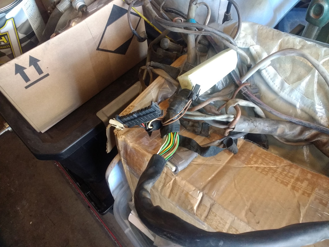

Old 05-16-2019, 05:44 AM
BHP231's Avatar
Join Date: Sep 2012
Location: Melbourne, Australia
Posts: 110
The plug image shows the receiver place for pin 21 looks empty.
The second photo shows the plug in place and the red connector near the dme which looks like it terminates to an earth point.

Well the FRWilk site is no longer, so I guess this information is no longer out there:
