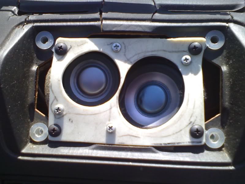

Just thought this was pretty humorous
I heard a rattling noise behind that cover on the center of the dash. Thinking it was that crappy original speaker, I popped off the cover. Too my shock, I found this, lol
Porsche center console
