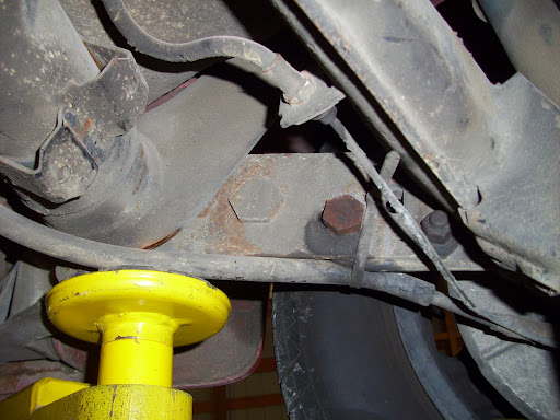

ideola,
I'm in the process of adding a rear sway to my early car right now. It didn't come from the factory with a sway on the rear. What are the brackets you are talking about. I'm buying the strap for the rear (pn:113-411-333-M100), with the drop links (pn:477-511-051A-OEM), the eccentric bolts (pn:477-511-515-OEM), lower shackle hex bolts (pn:N-010-452-4-OEM), along with all new bushing for the front and rear. I'm using 25.5mm front and 18mm rear bars (I will be buying new straps for the front because the early straps are too small in the front). What am I missing? When I've looked under it there is a place for me to put the straps in the rear already there. Is that what your talking about?
Thanks.

Well it looks like I have them on my car already then.
PS: where do I mount the eccentric bolts?
Old 08-09-2010, 01:56 PM
ideola's Avatar
Join Date: Nov 2005
Location: Woodstock IL
Posts: 1,705
Indeed you do!
See that big mother rusty nut in the middle of the spring plate? Remove it and put the eccentric in it's place.
