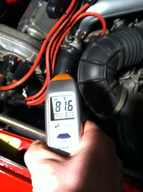

I may have answered my own question...maybe some of you would like to confirm my suspicion of the gauge.
I just picked up a thermo scanner and this is what I found:
This reading is just after I turned the car off. While running it was hovering around 83C...IMHO the needle should read a hair above the second line on the dash gauge, correct? It doesn't... it reads just below the 3rd mark. It should be noted that the thermostat I installed is a OEM 80C unit which replaced a 70C unit by the same manufacturer.
This is what the temp gauge actually means in C. According to this my gauge is always reading in the high 95-105 range give or take a few degrees.

Yep, our gauges are flaky. Check the wiring to the sender, and clean up all your grounds (under the dash, at the motor, and from the motor to the firewall).

As Rasta said it probably the guage, or more precisely the wiring connectors to the guage. Clean up the main connectors to the inst panel and all the grounds in the footwell.

It has to be the guage as you know the temp at the engine by the sensor is reading lower than the guage. The wiring must be good as generally a loose connection or bad ground will give you a higher resistance which will cause the guage to read lower not higher.
There is a test for the guage on Clarks, I would run that test and see if your guage is reading consistently higher throughout the range. If it is you can always carefully remove the needle and reset it to read correctly. Alternatively send it to a vdo service center or buy a new guage. Not much else you can do.
Personally if I knew for certain that my guage was reading consistently high and that the temp was actually ok, I would live with it.
