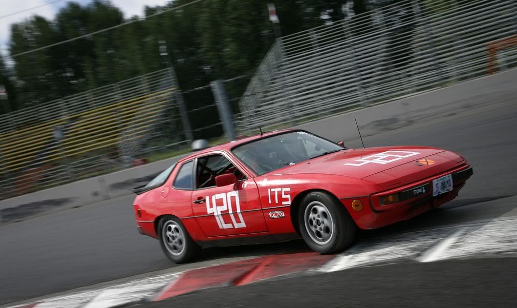

Have fun! We just did all this stuff to a 924S and this is what we got:
