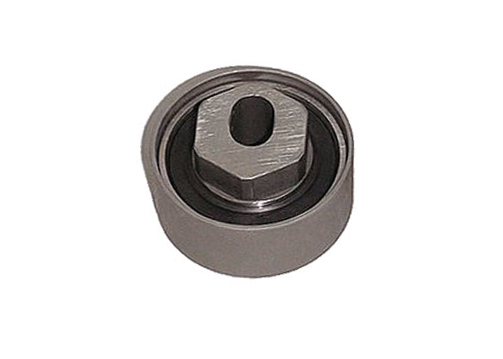

So, on my (new to me) '83 944 I have looked through the maintenance records and can't find any recent indications of a timing belt replacement, so I'm going to assume it's been long enough and get a new belt and go to town. The only thing is, I know that this job requires a special tensioner that is supplied by Porsche and very costly. When I search for the tensioner for my year one of the first results is this: 83 1983 Porsche 944 Timing Belt Tensioner - Engine Mechanical - Ruville - *********
It looks quite different to me than the Porsche device, can someone please enlighten me to what's going on?
EDIT: http://www.***********************/mmp/porsche~944~timing_belt_tensioner~parts.html
Perhaps the design was changed during a certain year? I must confess I don't know very well how the operation of the timing belt works

Those links are to the actual tensioner that is bolted to the engine and is an integral part of the timing belt system.
The 83-86 cars had the eccentric tensioner roller that was pretty simple to use although you have to use the P9201 tensioning tool to find the right tension value. The 9201 is probably what you were thinking of. it runs something like $625 new so it's quite an investment as far as rarely used tools go.
the 87-91 cars had a spring loaded tensioner that once you had your belts on you would release the nut holding the spring loaded tensioner arm and it would put a force on the belt and then you tighten the nut and it holds the arm in that place. Some people don't trust it. I do. No, unfortunately you can't put it on an early car.
Personally, I'd recommend for someone who has never done the belts to do them with the "twist method" and take it straight to a Porsche shop and have them tension the belts and make sure you put it together right. It will cost you something like $100 but it's worthwhile at least on the first time.
Other options are the "cricket" tool and the arnworx 902X. Many people here use them and they work good for the timing belt but as far as I know, you can't use them to tension the balance shaft belt.

Consider yourself lucky to have an early car - the eccentric roller is cheaper and much easier to work with and saves considerable time.
The late style spring tensioner is a POS, plain and simple. Adds another hour to the TB job.

My experience is that you can totally tension the belt just by using your own judgment.
I have personally seen reputable Porsche mechanics reach in there and give the thing a tug or two and then tighten the nut and let her rip.
I have found that there is a visual reference you can use to know whether or not it's in the ballpark.
First of all you want to turn the tensioner counter clockwise to tension the belt. So that it gets closer to the water pump pulley.
At this time the point of the hex part of the tensioner you have your wrench on points right about the center pf the water pump pulley, and you can make minute variations from there. If you are pointed at the center of the pulley you should be close with the tension.
I think the tensioner tool just complicates things and makes you question your judgment. However, the consequences are severe if you screw this up. The last time I had a head rebuilt it was about 300 bucks just for the machine shop bill plus a head gasket on top of that.

John_AZ, I was talking about the kind of tensioner without the spring, as viewed in the diagram above.
However whenever I see one tightened properly it is rotated counter clockwise, with the point that is facing the balance belt roller in the diagram approximately 270 degrees counter clockwise to what is viewed in the picture, which I think might be misleading to someone who is trying to line their tensioner up with that one.
Turning the tensioner counter clockwise puts more surface area of the belt in contact with the water pump pulley. And with the point of that hex aiming toward the center of the pulley you know you are close. What you see in the diagram is the flat side of the hex part that has obviously been rotated clockwise to tension, reducing the area of belt contact on the pulley which is wrong.

eliqunn,
Your experience may tell you the belt is correctly tensioned by the "hex part of the tensioner".
The point of Vans paragraph and my method is to protect the waterpump from bearing failure or seal failure which will happen if you over tension the belt.
http://forums.pelicanparts.com/6647314-post7.html
Your visual reference point may change if the belt has been on the car for 30K miles and has stretched.
New belts have to be retensioned after 1500-2000 miles and your visual reference point will not be the same.
