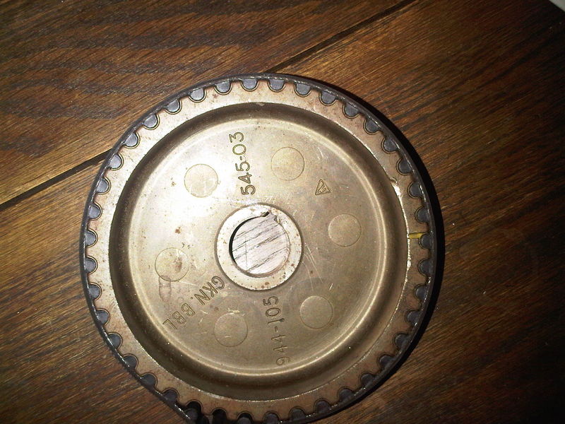

mattdavis11 12-09-2013 08:37 AM
I don't know what the numbers mean but the info below is exactly how the belt reads:
107 DO NOT CRIMP 09110 530282438
Made In USA
Here's a picture of the teeth not cutting the mustard.
http://forums.pelicanparts.com/uploa...1386610298.jpg
It's free to good home if you want it. Only attempted to be installed once, otherwise brand spanking new.

rhett 12-09-2013 10:34 AM
Made In USA
Info from the Gates website confirms that the 107 is a belt for the 8V 944...so, I guess the one you got is marked up wrong or very badly made!
