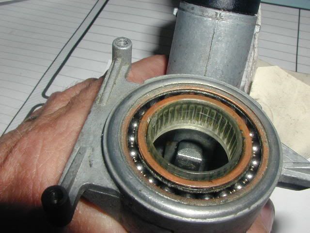

My steering wheel had some significant play in all directions, so I took the bugger off. The plastic thrust ring (the clear one, see picture) had completely disintegrated, so I ordered a new one.
Picture credit goes to kcoyle.
After receiving, I re-greased the upper bearing, reinstalled the ignition switch assembly, inserted the trust ring as far as possible (only about 1/2 of the way), and reinstalled spacer/blinker & wiper stalks/wheel. I used the steering bolt to tighten everything down, presumably pressing the thrust ring into place. Bad Idea™.
The black plastic spacer spread out and put a little undue pressure on the windshield washer stalk. I managed to get it off, but the thrust ring is pretty cracked and exceptionally tight. I've managed to move the ignition switch assembly a few fractions of an inch with a hammer and a pair of vicegrips, but it's going to take some serious effort to get it back off.
I'm pretty sure I'm doing something wrong here, as I assume the thrust ring is neither supposed to sit 1/4" off the bearing nor fracture on installation (though I could be wrong). What's the appropriate way to put this thing on?

Its because you are installing the thrust ring backwards. The thrust ring presses into the black plastic collar. The assembly is then installed with the lip of the thrust ring resting against the steering column bearing.
THIS METHOD IS INCORRECT!!!!!!!!:
What you will then do is simply pull the thrust ring out of the steering column bearing and turn it around. Grease it up and then press it into the plastic collar and install the collar with the thrust ring with the thrust ring towards the steering column bearing. Pm me if you have any questions.

Heh, that would do it... I wish there were some decent diagrams of this somewhere. The 924S PET is distinctly unhelpful (illustration 403-05 shows the support ring facing down on top of the clamping sleeve, and doesn't show the ignition assembly at all).
Incidentally, some searching turns up that Ian from 944online has a third method of installing this thing, namely inserting it from the back of the bearing on the ignition assembly.
Picture credit to Ian @ 944Online.
I'd imagine this method also required significant quantities of grease. I'd probably go white lithium (Murphy) because it's generally considered "plastic-safe". Can't speak for red lithium.

I ended up making up a technique based on the 944online method. The bushing position/orientation is as in Ian's image, but I put the thrust ring onto the steering shaft as far as it would go first, then pressed the ignition switch assembly on to it. Took minimal effort and removed the vast majority of the shake in the system (the remainder is wear in the bearing).
Murphy, the ignition switch is cake. Make sure the battery is unhooked, then just unscrew the hex bolt through the hole on the dash and pull (taking care to remove the wires). Insert and turn key if the steering lock gives you trouble.
On the other hand, the compreasion sleeve is a real bear if you havent had it out before (or in awhile). There are holes for a flat head screwdriver, but nowhere safe to use as a fulcrum. I generally end up using another screwdriver resting across the bearing housing.
