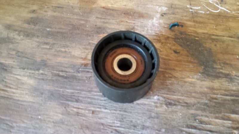

Timing belt tensioner roller kaput.
https://youtu.be/xAIveuV7gt8

Well, the tensioner roller was bad, but replacing it didn't fix the noise.
It was the timing belt idler roller. Took it off, ran the car and the noise is gone.
Will start another thread on my balance shaft fiasco.
