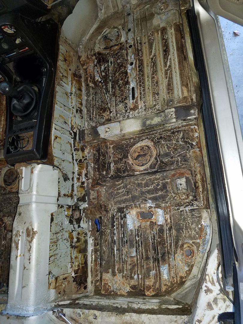

Old 03-30-2016, 04:19 AM
Certified Porsche addict
The Glademister's Avatar
Location: On a winding, hilly road in Tennessee.
Posts: 1,238
Drying out
The floor pan on this one was really wet. Passenger side mostly. The seat rails were rusty so it took quite a bit of PB Blaster to get them to break loose so I could remove the bolts. You just never know what you'll find under those seats. A PO must have lost her drivers license some years back. I got the rear carpet completely out, trashed the under layment and dried with heat gun. I'll let it sit open for about a week and everything should be dry. Also did some vacuuming in the engine bay. Took a peek at the timing belt - it will need replacement before I try to start the engine.

Old 04-09-2016, 07:31 AM
Join Date: Mar 2016
Location: Tulsa, OK
Posts: 240
My passenger floor was flooding and it turned out to be the seal around the blower fan squirrel cage. The one under the hood at the center of the firewall.
