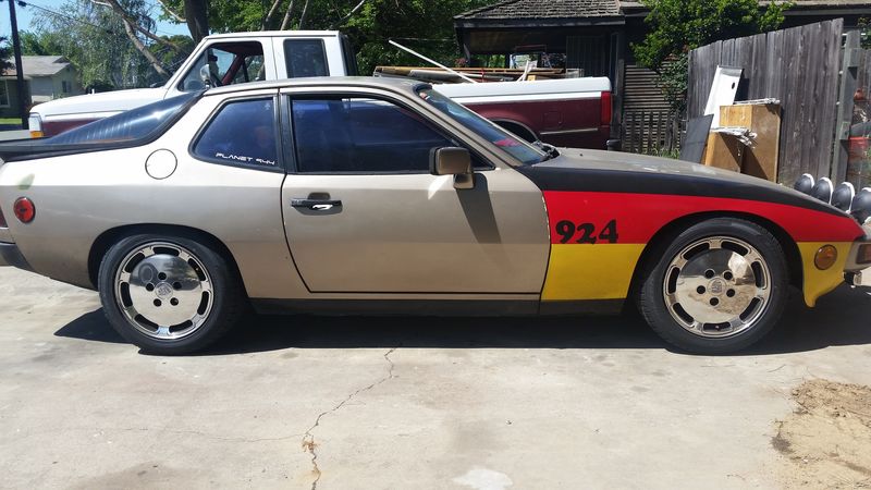

My car is an 87. PO may have been pulling my leg with the name of the rims. Not sure what the ET is. Tires on the car are 205/55 R16's The polished sewer lids would be a great improvement on my car, imo. Anybody want to trade???

Polished Sewers lids, look really good ^_^
